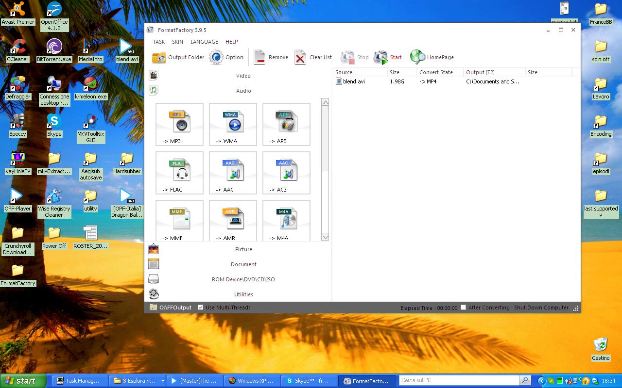

What about Format Factory?
Done in about... 5 min? xD It was super-fast xD I replaced encoders like ffmpeg and mencoder, then I replaced mediainfo as well and I managed to make Format Factory working in XP, as you asked! :D
Btw, I don't actually use Formact Factory, so I tested a few random audio and video encoding in H.264, xvid, AAC, AC3 and AMR and they worked.
link and images below:
psw: Itadakimasu0
https://mega.nz/#!mU0m0aLC!zz6JumB7N2-UIIoFENZ8SFKBfputXTzQIrdHuuFedmc
