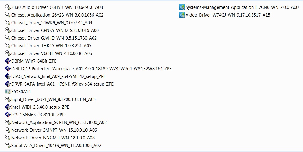

Maleny Posted February 28, 2015 Author Posted February 28, 2015 Looks like I shouldn't be messing with the BIOS at all, I was only assuming this was the reason my restore was not working.What I am trying to acheive (I think) is to do a full backup of my original computer with Acrois Trueimage. Then boot the laptop from the Acronis universal boot CD and tell Acronis in which folder it will find the chipset, HDD and HDD controller drivers as *.inf, *.sys or *.oem extensions.Acronis should then be able to do a universal restore (to a computer with different hardware) using the drivers it finds to suit the new hardware after which I can load the remaining drivers to get the laptop fully functional.It appears to me that Acronis can't see sub folders so I need to know exactly which files I need so I can put them were Acronis can find them and there are an awfull lot of files that have been extracted from the .exe drivers (I already said I was out of my depth). I have attached a screen print of the .exe drivers I have downloaded, maybe someone could tell me which ones I need.

submix8c Posted February 28, 2015 Posted February 28, 2015 From the Service Tag, the Original OS was Windows 7 -http://www.dell.com/support/home/us/en/04/product-support/servicetag/8RGFRY1/configurationThe Drivers you list doesn't jive in any way to what your Service Tag shows (for any OS), because your list looks "short"/"long" in all cases. Do you expect to move (whatever) OS from (whatever old PC) to this laptop (due to "other" software + all your documents)? You're going to get into a "Genuine"/"Activate" problem right away, regardless of the Drivers unless the correct "conditions" are met. We would have to assume that this Laptop is void of the Original OS (indicated by the SvcTag), right? Otherwise, you need tost transfer your Old Settings to the Laptop (MS version of PCMover, God help you). And I also agree, this Topic needs moved.
