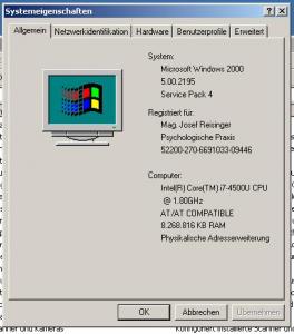

As you can see, windows 2000 works on haswell i7 and shows 8,2 GB RAM with /PAE also in standard-pc mode, thanks to blackwingcats extended core.
post-394729-0-61060600-1412194927_thumb.
Edited by JosefReisinger

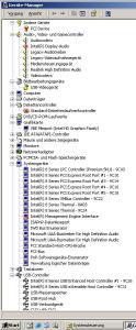

Only a few problem devices remain:
post-394729-0-82740700-1412195291_thumb.
*nvidia GT820M, which should be switchable with Intel HD Graphics. Both are known not to work in XP, too.
* Intel MEI (heci), which also does not work in XP.
* Intel HD Audio, which also does not work in XP.
* Video - Device (Webcam DEV_4F2&PID_B409), which works perfectly in XP with standard driver usbvideo.sys.
I found out, that all XP usb drivers can be used in w2k extended core: usbehci, usbhub (instead of usbhub20), and usbccgp, and all relevant dll files. So it should be possible to install the cam. It installs, but shows code 31 (cannot load driver). I tried with another webcam, which can be plugged into usb, same result. And I tried with usbvideo.sys from blackwingcats DVD and from german XP86 (xpsp3). Same result.
Perhaps another version of usbvideo.sys will do the trick. On the web I did not find anything. Would it be possible to get the enum section of usb registry USB\VID... from somebody here, who has usb 2.0 webcam running on w2k?
