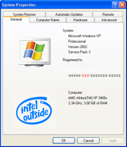

As to being "VLK" or not, that's easy: just right click on "My Computer" and select "Properties". You'll see a window like the pic attached. The "xxxxx-yyy-zzzzzzz-zzzzz" in it represents a number, known as MS Product ID (do not post your machine's full MS PID), of which the "yyy" part is the Channel ID. Now, any Channel ID begining with 6 (usually from 640 to 652) should mean "VLK". Just give it a look and you'll know for sure.
post-134642-0-82502900-1367704403_thumb.
That was easy. It's 640 = VLK.
Sure. That settles it. And, BTW, submix8c is right, Ghost can do it right. But, just to stay on the safe side, before proceeding, do use something like Magical Jelly Bean Keyfinder v1.5, or your favorite key retriever software, to retrieve and save the product key, just in case.
