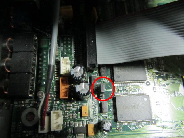

CharlotteTheHarlot Posted April 21, 2013 Posted April 21, 2013 In lower center right is the J1 jumper for onboard video. Is this the right setting to enable Onboard Video?You said "lower center right" ? Either my eyes are failing me or you posted the wrong photo. I see no jumpers in there. Unless maybe in that dark area to the left of the big cap in the center of the photo. Can you use a reference like "to the left of" any of the shown items ( e.g., audio cable or floppy ribbon cable, or the three empty connectors, or those two big IC's, the small cap, the transistor ... ). Or you could just circle it in a image editor. P.S. if it is behind that big cap, the trick to taking a picture is to have a small LED flashlight on it to cancel the shadow before you snap the picture. The flash from the camera will almost always cause a different picture than you expect because of incidental shadows that do not exist until you take the photo.
jaclaz Posted April 21, 2013 Posted April 21, 2013 To translate Charlotte's post in plain English:Hoko, you SUCK at taking photos! AND Charlotte's eyesight is not as good as it once was! The Jumper J1 is (on the manual AND in the photo) EXACTLY where it should be. (Yes, it's the right one for AGP video).jaclaz

Hoko Posted April 21, 2013 Author Posted April 21, 2013 To translate Charlotte's post in plain English:Hoko, you SUCK at taking photos! AND Charlotte's eyesight is not as good as it once was! The Jumper J1 is (on the manual AND in the photo) EXACTLY where it should be. (Yes, it's the right one for AGP video).jaclazThx Jac,Yeah, I should take some time and study my camera manual

CharlotteTheHarlot Posted April 21, 2013 Posted April 21, 2013 To translate Charlotte's post in plain English:Hoko, you SUCK at taking photos! AND Charlotte's eyesight is not as good as it once was! Thanks, I see it now ( d'oh! ). I missed that empty gold pin at the bottom of the jumper block ( so the jumper is on the upper two pins ).P.S. and yes, my old eyes suck.P.P.S. Oh, I didn't mean to criticize his camera skills, it's just a handy trick to know ( LED flashlight aiming at subject ). Often times you can then turn the flash completely off which results in no whiteout on reflective parts and usually means a longer shutter exposure as well. Better photo.
