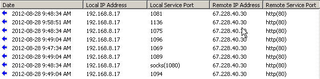

Me accessing MSFN.ORG (the Port 80 one) through my router (my router address=192.168.8.17 - multiple ports):
I am not sure to understand, those seems a lot like OUTbound connections and not INbound ones.... :unsure:
Yeah, a little goofy-looking. It appears that the Outbound are legitimate. Apparently, it's part of the communications cycle. Details of one (Symantec Firewall, BTW):
