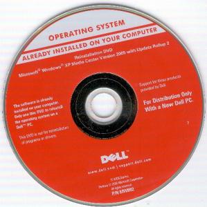

edit - re your MSI DVD - this is my Dell one (not hologrammed).
post-72994-0-62487200-1345318739_thumb.j
