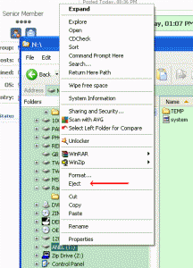

dencorso Posted April 20, 2012 Posted April 20, 2012 OK. So let's investigate the pendrive some more. 1) How did you make it bootable originally (they usually are not)?2) Please download ChipGenius, run it with the pendrive inserted (under XP SP3) and post its report on the pendrive.3) When you insert it, under already running Win XP SP3, and then open Windows Explorer and right-click on the pendrive's letter, is there an "Eject" entry on the pop-up menu (as indicated by the red arrow in the attached image)?
