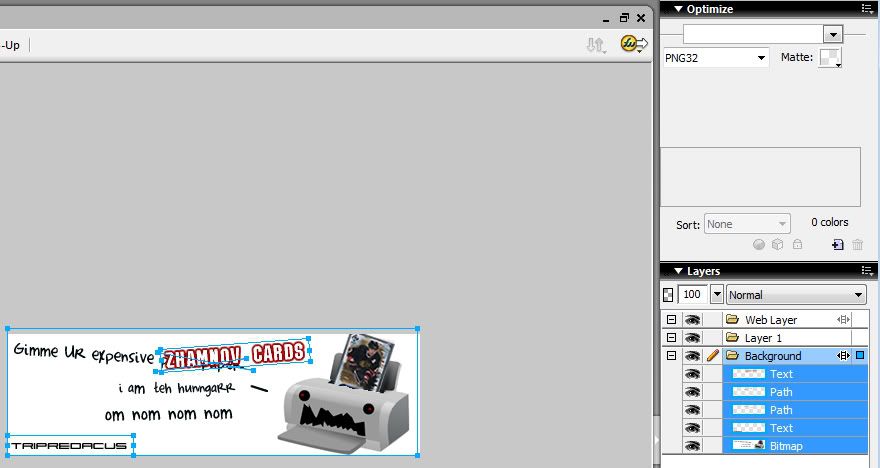

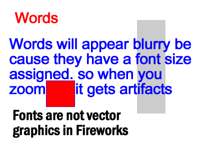

Tripredacus Posted August 10, 2011 Posted August 10, 2011 (edited) Neither of those PNGs are truely PNGs anymore, except perhaps if they had any alpha transparency in them. These are already flattened and not longer maintain their vector properties! I've encountered this before trying to export items from Photoshop in order to work on them in Fireworks, I found the PNG format is not preferrable. Photoshop makes them basically act like JPGs, which is why the zooming makes them appear to be JPGs. Also the color difference isn't a fault of the browser, as Fireworks shows them in that color as well. IMO, PNGs should only be used when you need a high resolution image that contains transparencies. For this, GIFs are not a good use, use PNG instead. Otherwise, the complexity differences are negligable in the PNG vs JPG debate.AFAIK the browser does not do anything with the layer or vector metadata in a PNG file. I rarely will keep a PNG around unless I feel the need to work on something again in the future. In that case, I can re-open an old PNG and make changes easily, but only if the PNG wasn't exported or flattened. This is even possible between different versions and installs of Fireworks. However for some reason Fireworks isn't a commonly used program so you'd be hard pressed finding any PNGs online that were natively saved with it.Example, PNG created by a different Fireworks on a different computer, opened on this PC (after it wants me to replace fonts) shows layers and vector properties still intact:And I made a PNG just for test with 5 layers. Two are shapes and three are word blocks.If I download this "yarrr" (its on Photobucket) and open it in Fireworks, the layers and vector shapes are still usable. Edited August 10, 2011 by Tripredacus
