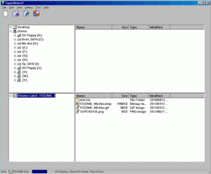

"Burning" a 32MB floppy disk
A regular 1.44MB floppy disk can be formatted and written to only with the SuperWriter32 software, which is part of the Matsus***a SuperDisk Utiliy. 32MB formatted floppies canNOT be written to by any other software, e.g. Windows Explorer, Beyond Compare, Norton Disk Doctor or ScanDisk. Only SuperWriter32 can write to a 32MB floppy; all other programs have only read access to a 32MB-formatted floppy. A 32MB floppy disk can be compared to a CD-RW disk, but without packet writing software. SuperWriter32 can "re-burn" a 32MB floppy disk with a new compilation..
SuperWiter32 is similar to a CD burning program: The upper part of the SuperWriter32 window is the source, the lower part is the target (see attached screenshot). Files and folders can be added to the target only by drag-and-drop from the source window of SuperWriter32, not by drag-and-drop from an open Windows Explorer window. The compilation is "burnt" to the 1.44MB floppy disk by selecting -> File -> Write.
post-183045-0-98497600-1311094985_thumb.

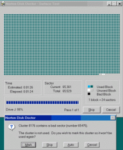

32MB formatted floppy disks - Bad Sectors (1)
When SuperWriter32 formats a 32MB floppy disk, bad sectors are created in the free space (see the screenshot below, NDD msg: "The cluster is not used"). A binary compare with Beyond Compare of the original source and the files on the 32MB floppy is Ok however, since the bad sectors are not in the used data area. So these are apparently innocuous bad sectors.
BUT: If you have inserted a good 32MB floppy and:
1) selected in SuperWriter32 -> Settings -> Write Mode -> File At Once (FAO)
2) then add or delete files in the SuperWriter32 target window
3) then select -> File -> Write
the 32MB floppy disk will become corrupted somehow and Beyond Compare will indicate errors and eventually you will have to reboot. Maybe things go wrong when SuperWriter writes new files over bad sectors in the previously unused area.
It looks like FD32MB incremental writing was the last feature added to SuperWriter32 v2.03, and is an unfinished work-in-progress which never got fixed, typical for last builds/last versions. Never use the File At Once (FAO) write mode, only use the Disk At Once (DAO) mode.
Bad sectors in the not-used data area can be ignored if the Disk At Once (DAO) write mode is used. A freshly FD32MB-formatted, blank floppy disk causes NDD to display in the surface test always the err msg "Cluster 5 contains a bad sector (number 112)", but "burning" a compilation to this 32MB-formatted floppy disk creates a good floppy, which again has a bad sector in the not used data area.
BTW, the surface scan of the 32MB-formatted floppy disk in the LS-240 drive is fast (1:24 minutes for 31.9MB), as shown in the attached screenshot.
