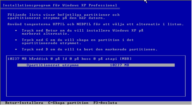

I have been a member for some years and now I trying to learn the procedure of booting and installing Win XP Pro from USB.
Have been reading up i this subforum, but I nevertheless have some simple basic questions to ask. I know how to work nLite, like it and use it, and I have absolutely no problems to get a install from a cd to work.
I really like to connect to/join the install process at the time where I can adjust the different partitions (picture attached) and then run the installation as I use to do it from the cd.

...I really like to connect to/join the install process at the time where I can adjust the different partitions (picture attached)...
Can you elaborate on this one, what do you mean? All methods in this subforum will get you to that screen...

After reading about the different versions of usb installs I thougt that they all went direct through this part of the install (in with the usb, smack - bang everything ready after a standard install)... my languageproblem I see now.
So - after all I have a couple of different medthods to choose from - my I ask for a recommendation - the first sticky by cdob looks pretty nice - since I work with completed isos (winxppro, 32bit). Have you any idea which method is most stable?
