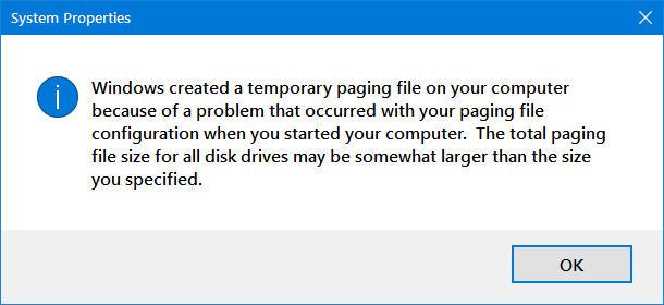

click-click Posted August 23, 2023 Posted August 23, 2023 (edited) After creating a vhdx for w10 LTSB, I keep getting an error about the paging environment and can't get rid of it. It's been a while since I used a VHD. I don't remember having this problem previously. I created the vhd without a page file for testing since I have 16GB memory. Any idea what's causing this? Edited August 23, 2023 by click-click
click-click Posted August 23, 2023 Posted August 23, 2023 (edited) Sorry, user error. I set nopaging via the WinNTSetup ini file, but somewhere along the line my install applied the following reg that I use for HDD installs and that ended up confusing the system. Even changing it back to no paging via the GUI did not help. Had to redo the vhd without using that reg file. Windows Registry Editor Version 5.00 ; Generated by Total Uninstall ; Change Page size 512MB 1536MB [HKEY_LOCAL_MACHINE\SYSTEM\CurrentControlSet\Control\Session Manager\Memory Mana"PagingFiles"=hex(7):63,00,3A,00,5C,00,70,00,61,00,67,00,65,00,66,00,69,00,6C,\ 00,65,00,2E,00,73,00,79,00,73,00,20,00,35,00,31,00,32,00,20,00,31,00,35,00,\ 33,00,36,00,00,00,00,00 Edited August 23, 2023 by click-click
