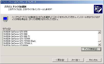

blackwingcat Posted June 15, 2015 Author Posted June 15, 2015 I released nVIDIA 353.06 driver for Windows 2000. I hope someone test it on GeForce 980Ti or Titan X or Titan Z
