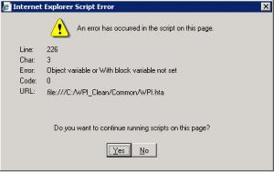

Hello
I get an error when starting WPI v8 exe on Windows Server 2003 R2 32bit and 64bit (both tested), no problems so far on Windows Server 2008 64bit, Windows Server 2008 R2 64bit, Windows 7 64bit.
I used the downloaded and unmodified version, with no own config, userfunctions, useroptions or something else, to exclude errors in my own configs.
Internet Explorer Script Error
An error has occured in the script on this page.
Line: 226
Char: 3
Error: Object variable or With block variable not set
Code: 0
URL: file:///C:/WPI_Clean/Common/WPI.hta
Or see the attached screenshot.
Hope it helps you to fix this error. I really like v8, waited a long time for an update..good job!!! :D
Working with schneidwui via email.......

I think schnedwui's error was the same as mine - because I had exactly the same message.
I my case it was the problem of IE6 (or its settings) - because my XP Home was a clean install without updates.
After update to SP3 (and all later hotfixes) the problem was also gone without the fix.
