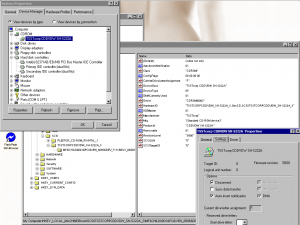

Drugwash Posted July 2, 2009 Posted July 2, 2009 As promised, with apologies for the delay:First attempt at getting DMA enabled failed on a Win98SE2ME AMD K6-II machine with an ALi chipset. However, it also failed for the Plextor PX-54TA CD-ROM that I already had mounted on that machine and I do remember that particular Windows installation has been quirky in regard to DMA back when it was run on its original mobo. So I'd file this test as inconclusive.Second test was performed on a Compaq Deskpro EN400 under Win95 v4.01.971 B. As can be seen in the attached screenshot, the IDE controller is the very same as Rivia's, the only difference being that my DVD-RW has firmware revision SB00 as I had not yet searched for an upgrade (and well... if it ain't broke, don't fix it )DMA got enabled by itself as soon as I mounted the drive and it appears I do have the Intel Bus Master driver installed. So despite this isn't a Win98SE system, I'd say the drive should work fine with DMA enabled. The conclusion I would draw is either (in order):1. Your IDE driver is bad/badly installed.2. There is hardware incompatibility between the DVD drive and the IDE controller(s) on your mobo.3. The SB01 firmware revision breaks DMA (only in certain configurations, maybe)4. The drive is defective
Rivia Posted July 2, 2009 Author Posted July 2, 2009 Hi, I thank you again for the time you took in helping me. : Charlotte :I won't have very much time in a near future to change my internal connections again and make new tests with the registry and so on... I'm not the only person who is using this PC, so it has to be operational from time to time... If I a propitious period occurs (maybe during holidays), I will try what you suggest and give you reports.Drugwash :Interesting... the only difference here seems to be the firmware version. One thing I could perhaps try would be a downgrade of the drive, if I can put a hand on a SB00 version ?PS : you apparently use some very nice wallpapers, don't you ?
