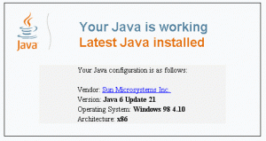

EvanD Posted August 6, 2010 Posted August 6, 2010 Sorry, EvanD, but it's not a proof. I could show you exactly the same picture from my Firefox 3.5.11 (it means only that Java 6 update 21 was installed on your PC).Have you tested Firefox 3.6.8 and Java on such sites?http://www.javatester.org/ or http://www.java.com/en/download/help/testvm.xmlYou're right, with Firefox 3.6.8 on javatester.org, the applet test fails. However, JRE u21 works on all the sites I normally go to including the Flash test which, from previous msfn.org discussions, I was led to believe requires some form of a java applet to work (isn't that why we uncheck "new java plugin?").For IE6, JRE u21 does work. See figure. It does not work for Seamonkey 1.1.19.I plan to keep JRE u21 for a while until I run in to a practical problem. When that happens, I'll revert back to u20.Thanks for alerting me to try the direct Java applet test; at least I now know there's a potential problem lurking ahead. Is there something I should be wary of?
rainyd Posted August 6, 2010 Posted August 6, 2010 (edited) You're right, with Firefox 3.6.8 on javatester.org, the applet test fails. However, JRE u21 works on all the sites I normally go to including the Flash test which, from previous msfn.org discussions, I was led to believe requires some form of a java applet to work (isn't that why we uncheck "new java plugin?").For IE6, JRE u21 does work. See figure. It does not work for Seamonkey 1.1.19.I plan to keep JRE u21 for a while until I run in to a practical problem. When that happens, I'll revert back to u20.Thanks for alerting me to try the direct Java applet test; at least I now know there's a potential problem lurking ahead. Is there something I should be wary of?That quite interesting: it means that latest Java could work on some sites (or not) with Firefox 3.6.8. Yes, it's a right picture but because I do not using IE 6.0, it is a minor success IMO.I would advice you, to try just much as possible various Java oriented sites. Btw, have you checked http://www.pluginchecker.com/ mentioned by WIN98SE/schwups? Edited August 6, 2010 by rainyd
