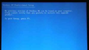

So, as a side note, if I try SetupSourceDevice with harddisk0, it tells me "No previous version of Windows NT can be found..." [press F3], like so:

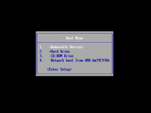

* Boot from USB goes fine, I use F12 to temporarily select USB

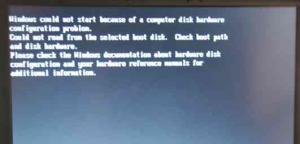

* I think it tries to boot from harddrive, but it doesn't seem to work, for some reason.
I get the following screen with the text starting with
"Windows could not start because of a computer disk hardware configuration problem.
Could not read from the seleected boot disk. Check boiot path and disk hardware.
Please check the windows documentation about hardware..."
What could the problem be?
What can I do about it?
Have I missed some step?
Thanks for your replies and your time!
/mawi
Wrong rdisk value in boot.ini on the internal disk...

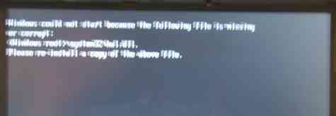

After first phase (blue/text mode) reboot, I then get a new error message:
"Windows could not start because the following file is missing or corrupt:
<Windows root>\system32\hal.dll
Please reinstall a copy of the file."
I have tried this twice now, and I get the same error message.
It seems that I may have missed some edit in TXTSETUP.SIF?
If so, what?
Thanks again!
/mawi

This one should be because of wrong partition(X) value in boot.ini. Did you start from USB the second time? Does partition number in boot.ini match the partition number you installed to?
Do rdisk values in boot.ini on the internal hard disk match?
Since you can boot from PE disk you should post the relevant information, this would save both parties time.
In other hand- what are you trying to accomplish? Need one-off install or you are willing to experiment?

ok one things ur txtsetup is not right u changed it
39 = "Driver Cache\$WIN_NT$.~BT"
try use f12 button when the system start to load the bios boot menu
and choose directly the hdd / usb that have the setup files
if its not working try change back to hdd(0)
"No previous version of Windows NT can be found..." [press F3], like so: "
i had that problem while making this but i solve it

Booting is OK, files are transfered, but at reboot HAL.DLL is missing.
