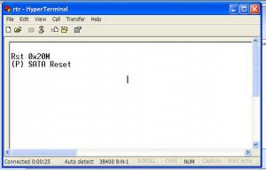

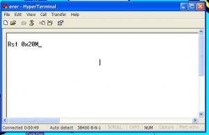

SAFIX Posted July 12, 2009 Posted July 12, 2009 (edited) I've managed to update the firmware and get a response from the drive but it seem to get stuck at this stage.With isolatorwithout isolatorbut the symptoms are still the same gets detected once only... Any ideas out there? Edited July 12, 2009 by SAFIX
