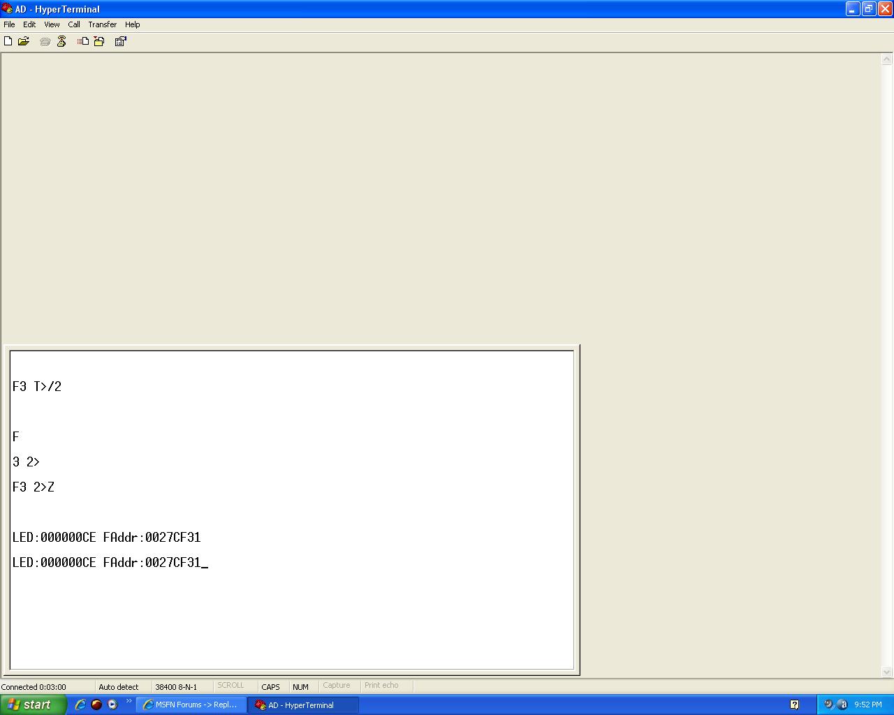

Im running into a bit of trouble. When I do all this, I connect all the wires and connect the circuit to the rs232 and open up HT then put all the settings in. When I hit ctrl+z I get no response. Ive switched the tx and rx around and still nothing. Ive tested the connections and they all come back in good standings. I dont know what im doing wrong or if I have to update something?
I will be trying to unbrick my HD later using a ca-42 or dku-5 cable...hopefully all goes well. Question though, what's the tx & rx color for these cables? thanks!
Well, im back again.
Ive got my other problem fixed it was the tx to rx connectors.
But now another problem pops up.
Heres a pic of the error
If someone could help me out, it would be greatly appreciated.
Just post back if you need some more info.
