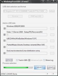

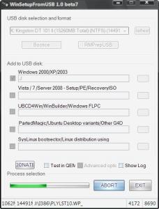

NikLok Posted December 28, 2010 Posted December 28, 2010 It will be very well if design of main window little improve.Because in my monitor in 120dpi font resolution i have next views:text on button is croppedpROGRESS bar on stage DONE not 100%

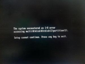

Virus Posted December 28, 2010 Posted December 28, 2010 I just got over 1TB HDD and wish to install WIN XP. I already have one Disk which has win 7 installed, but during my install I had disabled that Disk so as it does not corrupt the MBR of that disk..I am not being able to reach the Text Menu even. My system does boot from USB and gives the options to chose where WINDOWS is installed. After that whatever I chose I either get <WINDOWS ROOT>\...\HAL.DLL not found.My boot.ini file looks like following[boot Loader]Timeout=5Default=multi(0)disk(0)rdisk(1)partition(1)\WINDOWS[Operating Systems]multi(0)disk(0)rdisk(1)partition(1)\WINDOWS="rdisk(1)partition(1)" /FASTDETECTmulti(0)disk(0)rdisk(2)partition(1)\WINDOWS="rdisk(2)partition(1)" /FASTDETECTc:\="-------------------------"c:\="Try entries below if getting HAL.DLL/NTOSKRNL.EXE not found errors"c:\="--------------------------"multi(0)disk(0)rdisk(3)partition(1)\WINDOWS="rdisk(3)partition(1)" /FASTDETECTmulti(0)disk(0)rdisk(4)partition(1)\WINDOWS="rdisk(4)partition(1)" /FASTDETECTmulti(0)disk(0)rdisk(0)partition(1)\WINDOWS="rdisk(0)partition(1)" /FASTDETECTmulti(0)disk(0)rdisk(2)partition(1)\WINDOWS="Second part of XP Professional setup from hd 1 part 1" /FASTDETECTmulti(0)disk(0)rdisk(2)partition(2)\WINDOWS="Second part of XP Professional setup from hd 1 part 2" /FASTDETECTmulti(0)disk(0)rdisk(2)partition(3)\WINDOWS="Second part of XP Professional setup from hd 1 part 3" /FASTDETECTmulti(0)disk(0)rdisk(2)partition(4)\WINDOWS="Second part of XP Professional setup from hd 1 part 4" /FASTDETECTI have tried various combos regarding the DISK and Partition number but nothing seemed to work.Kindly advise what I am missing on. I used WinSetupfromUSB 0.2.2.While Installing I had only One HDD, set as my secondary HDD. Primary being the USB drive(8GB), both key and HDD are formatted as NTFS.Let me know if any other detail is requiredThanks in advance.
ilko_t Posted December 28, 2010 Author Posted December 28, 2010 ...P.S. It worked. Many thanks Thanks for the feedback.It will be very well if design of main window little improve.Because in my monitor in 120dpi font resolution i have next views:.Putting it in the to-do list.I just got over 1TB HDD and wish to install WIN XP. I already have one Disk which has win 7 installed, but during my install I had disabled that Disk so as it does not corrupt the MBR of that disk..I am not being able to reach the Text Menu even. My system does boot from USB and gives the options to chose where WINDOWS is installed. After that whatever I chose I either get <WINDOWS ROOT>\...\HAL.DLL not found.Well, it's perfectly normal to get these errors if you haven't passed the first part of setup. The point is why it's not showing up.Use either the latest stable 0.2.3 version or even better- 1.0 beta7 and try again.It would be good idea if you only disabled the other internal disk in BIOS to disconnect it, not only disable it.
Virus Posted December 30, 2010 Posted December 30, 2010 HI ilko_tmThanks, i was able to make it work by using the latest version. The version i had was not installing the grub4OS on the pendrive. this was not allowing to actually start the installation. Got the latest version whihc did the needful.Well now stuck with multi-os boot problem Hopefully will be able to resolve using the EasyBCD. I have installed WinXP on a system whihc already had Win 7 installed. Will keep ya postedCheers!!!Virus
