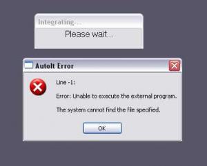

Like kalle_mod, i have a error when integrating hotfix KB942571 into Office 2003 admin install (with Sp3 not integrated).

Hi,
i have the same problem with office 2003 sp3 admin integrate, i add hotfix 942571 and obtain this error too.

i don't have 7zip.
  • Author
OK, I just got my new computer. I'll check for this errors and I'll try to fix it. In meantime, everybody who have problems with this error should try to install 7-Zip.
