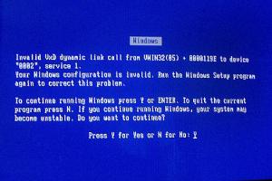

  24. Yes, it does sound as if patchmem is perhaps not doing what it should do (I assume that you are using one of the correct versions.) The VMM BSODs you're getting now can happen in my experience if you've got too much RAM and/or a very large registry. Patchmem has cured all that for me. I'm sure you've tried this, but when it hangs on the restart, have you tried restarting in Safe Mode? I have known Windows 98 hang on reboots after installs, but Safe Mode starts OK and does the registry updates etc., and it will then boot OK in normal mode. Worth a try if you haven't tried that. The only other thing I'd now try before reinstalling Windows is to go to the system\vmm32 folder (in DOS), and restore the backups that should be there of your vcache.vxd and vmm.vxd files. These should have been made by patchmem and have a *.bak extension. Then boot into Safe Mode with the original graphics card installed and use the system configuration editor to limit the memory to 512MB. With a bit of luck the system should then boot into normal mode again and you can reinstall patchmem and take it from there.
