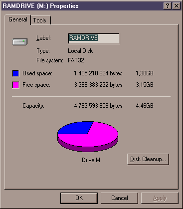

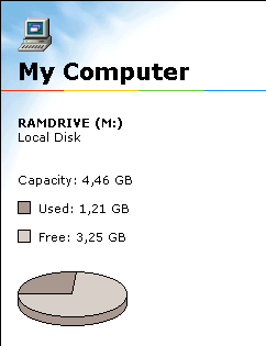

I was able to find out that "MS-RAMDRIVE" is located in "KERNEL32.DLL". I just changed it to "MS-ROMDRIVE", replacing one letter ("A" with "O") and it worked! In other words, the name is mapped exactly from there. The question now is, is there any way to cut off "MS-" painlessly so that it doesn't affect everything else? Simply deleting these three characters is not an option - the code will shift and the OS will not boot. Is it obvious that some other approach is needed here, or does this issue not have a simple solution?
SweetLow, hi, do you know where Windows gets the ramdisk mapping from to the disk name "MS-RAMDRIVE"? With a different name, as shown in the screenshots above, the disk is defined as "Type: Local Disk" and assigned an icon corresponding to the local disk. If you enter the name "MS-RAMDRIVE", the icon changes to microchip and the type changes to "Type: RAM Disk". When it is RAM Disk in "My Computer" it is easy to immediately distinguish it by another icon. And so (By default), it merges with other (Regular) disks, without being distinguished in any way. It would be possible to leave the name "MS-RAMDRIVE", but as I wrote earlier, it is too long and does not fit completely. I would like to make the name "RAMDRIVE" by default and that it would be defined by the system as "MS-RAMDRIVE", assigning it the correct type and icon.
Most likely, some volume is reserved by the built-in graphics. This value can usually be changed in the BIOS. I also have 8GB, but the ramdisk size is different: However, no values in the registry had to be changed. It immediately took up all the available space and was automatically formatted in FAT32. Perhaps, in your case, the crucial role was played by changing the amount of RAM from 6GB to 8GB.

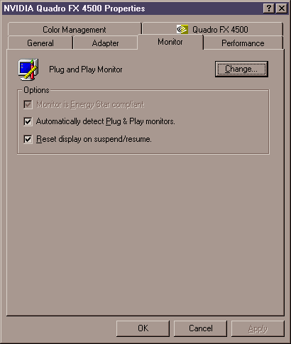

Hmm, then I don't even know, this is some strange, very exotic mistake. I've never seen anything like it. You can then try turning off DDC. And also in the properties of the screen, try to turn off the power saving functions (Maybe they don't work correctly) by removing all three checkboxes and then performing a reboot: -

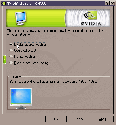

A bit offtopic, but for the sake of fairness, I also checked what would happen if a full-fledged CRT monitor (based on Mitsubishi DiamondTronNF) was connected under the same conditions. What it will look like. And here's what came out of it: VGA NV34 with CRT: 320x200 => 640x400@71 Aspect 360x200 => 640x400@71 Aspect 320x240 => 640x480@72 Aspect 360x240 => 640x480@60 Aspect 320x350 => 640x400@70 Aspect 360x350 => 640x400@71 Aspect 320x400 => 640x400@72 Aspect 360x400 => 640x400@71 Aspect 320x480 => 640x480@60 Aspect 360x480 => 640x480@60 Aspect 640x400 => 640x400@72 Aspect 640x480 => 640x480@72 Aspect 800x600 => 800x600@72 Aspect 1024x768 => 1024x768@72 Aspect 1280x1024 => 1280x1024@72 Aspect As you can see, the number of playable modes immediately increased. Moreover, in each case, the aspect ratio is now correct (Which is achieved due to more subtle settings of the monitor itself, which, as it turned out, allow significantly more than the LCD. For example, completely arbitrarily narrow-expand any image horizontally and vertically, regardless of each other). And another thing that immediately caught my eye was that, unlike the LCD, the lubrication was completely lost when driving. Three-dimensional space moves like something real behind glass. There was no such effect on the LCD, and with any settings and connection methods, there was always a barely noticeable smudge when strafing near a wall or any object, which causes noticeable damage to realism. But nevertheless, returning directly to the topic, I managed to find out that this problem has already been encountered and tried to solve it with a hardware DVI cable mod (Which in general is almost the same as I have already done, only without flashing the modified EDID directly to the monitor itself). They also tried to modify the BIOS, but these are all half-measures. This is not flexible, difficult, and requires significant intervention. Therefore, it is difficult to consider all these solutions as full-fledged and easily accessible to everyone. I would still like to find ways to make do with purely software tools.

It's clear. It turns out that there are several possible scenarios at once. Older vBIOS can understand PTB EDID values, such as those that correspond exclusively to GTF. But don't quite understand CVT, CVT-RB and CVT-RBv2 (Specified in the EDID for DVI \ HDMI of a modern monitor). Therefore, the BIOS chooses something from the standard values when it suddenly encounters an unfamiliar "CVT", and even at 16:9. Hence, 1024x768 (apparently GTF) is forced. Another option is that 1024x768 can simultaneously be a certain " vBIOS Default "and it is always reset to it when it cannot set the requested"CVT". This can be easily checked, but you will need to modify the EDID again. Replacing 1600x900_CVT with something not quite standard, something like 800x600_GTF. The old vBIOS should understand this if it really accesses this block (PTB). And instead of 1024x768 at the input, if everything is really so, it should immediately become 800x600. Otherwise, this mechanism does not work at all in NV34 (not implemented yet\Disabled by default\Disabled for this particular monitor\Works differently than expected). Well, accordingly, the resulting option may be just the same in the fact that the old vBIOS may not read this block at all and just choose something from the standard values at once. But then again, why is only one single value always used? There are also a lot of them (There is, by the way, and 1280x1024@75hz, why not choose it, for example?). Judging by this behavior, it seems to me that it still uses internal values from vBIOS (Choosing only one of them). And what it starts from then, choosing this "only correct" value, if not from EDID, remains a mystery. I also looked a little bit at UniVBE on NV34 (So far only superficially, it is quite buggy and it has two different recommended versions, the behavior of which is slightly different, as well as their glitches. Therefore, all the following observations are only preliminary). With DVI allows you to still change the frequency up to 75hz at 1024x768, but only if the game itself is selected exactly 1024x768. When you select any other modes, the input to the monitor remains as before 1024x768@60hz. Also such an option. It's just a coincidence that the game has such a display mode. Some games can't even exceed 800x600_Vesa2 (or even even less), which means they're all out of whack? Well, the limit of 75hz is clearly not hardware. But on the G70, of course, this does not work at all, because the game does not support 1920x1080 or even 1600x900 (Which UniVBE or vBIOS chooses). Accordingly, it cannot be selected in the game. And if you wind up even just 60HZ at the same 1024x768 or 800x600 and select it in the game, it immediately writes that there is no signal (That is, it tries to do something there, but it clearly breaks off about something and flies out of the range). I will dig up this effect in more detail. Notably, UniVBE itself acts similarly to VBIOS in both cases, setting hard-coded 1024x768 for NV34 and 1920x1080\1600x900 (depending on the EDID) for G70. That is, it does not bring anything new in this regard. Presumably, if you set EDID 1024x768 as preferred (PTB), then the G70 will be able to work similarly to NV34. But this solution, again, is not perfect, for the same reasons. Along the way, I also managed to find out that data from the EDID is read every time the video mode is changed in the game. Thus, on the fly, in principle, it would be possible to change the preferred mode and refresh rate so that the video card would actually use it. But this requires a powerful software tool that allows you to modify EDID data on the fly (something like "EDID override for DOS"). Or a deep revision of UniVBE could also be a good solution to quite a few similar problems, because, among other things, it also added new modes to the game (Which were not originally available), and also includes support for VBE 3.0 (Where it is not yet\no longer yet), although it actually turns on not everywhere (at least as far as the refresh rate is concerned) and usually doesn't work on anything higher than NV3x (at least on VGA. On DVI, as you can see, too, a positive result has not yet been achieved). I also checked "Aspect". The actual aspect ratio (If measured with a measuring tape) of the 1024x768 video mode under DOS, embedded in 1600x900 (Which the video card outputs) and applied to it by the "Aspect" monitor, is 4:3 (400x300 millimeters physically). Of course, when in Windows, in the same framework, the size of 400x300 millimeters, 1600x900 remains embedded - this does not look natural. But this can be easily corrected even in several possible ways (by setting the video driver zoom, changing the refresh rate to a different one than used under DOS, or by setting the monitor itself). So this is just not a serious problem here (Just an annoying flaw).

It thus scales 1600x900 under DOS (And in the DOS window of Windows), in the case when it is entered in the standard 4:3 (For example, 1024x768). And after completing the full-screen DOS application and returning to Windows, these "incorrect" proportions are preserved for 1600x900 installed on the desktop (Texts and shortcuts are narrowed, and black bars remain at the edges). At the same time, from a "clean slate" under Windows, the monitor does not allow you to set the "Aspect" mode (Other options are available besides this). For this zoom mode to become available again, something must be written in 1600x900 under DOS. It looks very confusing. Most likely, this still corresponds to some interaction specification. Somehow, the monitor under DOS determines the parameters and the ratio of the entered resolution. But this is not the right behavior. It is necessary that the video card outputs, for example, 800x600, as it is (As it is selected in the application), as it happens with a VGA connection. UniRefresh + Quake 1. What other apps can I try for this purpose? The output in DOS does not work for me (It exits and freezes). Only a separate MS-DOS 6.22 (Multiboot menu of Windows 98) works, in which I test all this. The DOS window also works under Windows 98 (Also used). Running DOS received with "BootGui=0". As well as DOS, located on the OEM CD of Windows 98. Everywhere the picture is almost identical. The scaling settings, in turn, apply to the DOS window of Windows 98. But only the first two options work (Enter in the center or Stretch). The third option (Passing native permission) doesn't work. For pure MS-DOS 6.22, the tool mentioned above (In the sixth message) is used: http://rayer.g6.cz/programm/nvsc.zip It also allows you to use only the first two options (Fit or Stretch). At the same time, under any DOS, the above method of scaling the monitor is always used, determined by the entered resolution. The monitor input is always supplied with what is specified in the monitor's EDID (including the refresh rate). And so it happens. I try changing the refresh rate as usual using UniRefresh, but it doesn't work for DVI connectivity. Only for VGA (and even then, not on all VBE 3 compatible nVidia video cards).
