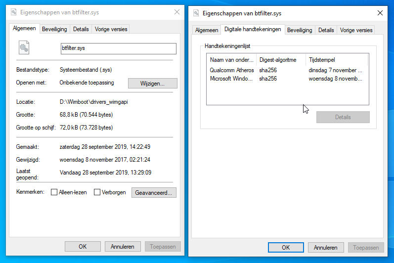

  2. After Apply with wimgapi + WimBoot mode then the three problem drivers have in Properties missing Digital Signature tab After wimgapi Replacing simply the three drivers btfilter.sys and nvhda64v.sys and TeeDriverW8x64.sys by the drivers found in the wimlib installation solves the problem. That means the problem is entirely located in the three drivers having missing Digital Signature tab after Apply wimgapi + WimBoot mode Then I investigated the drivers in TinyHexer. To my surprise the driver file after Apply of wimgapi + WimBoot mode is completely filled with byte 00 [PrepopulateList] files WOF Uncompression Failure resulting in zeroed driver file ? After Apply wimgapi + WimBoot Mode After Apply wimlib + WimBoot Mode

  5. Thanks for giving info about where and how to find driver certificate info. The three drivers giving problem have their signature inside the sys file. The drivers appear as Unsigned, but after Update driver then the same driver file appears as Signed. So it seems to me that the only problem is that the Certificate is not recognised ....
