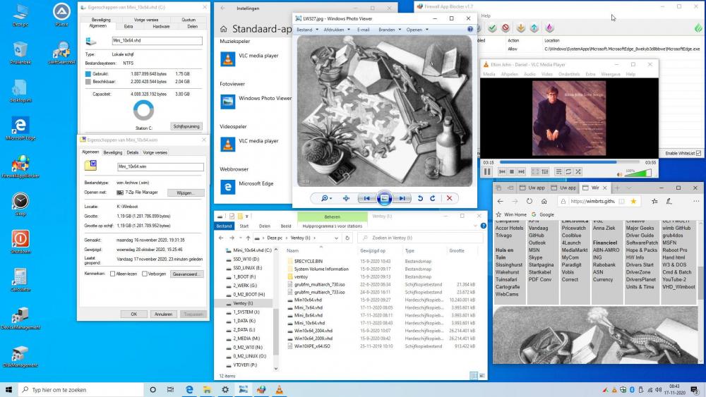

Mini_10x64.vhd is booting as FILEDISK from USB in UEFI Secure and in MBR BIOS Legacy mode also when located on Ventoy NTFS drive using ventoy_vhdboot.img VHD of 3.9 GB has UsedSize = 1.75 GB

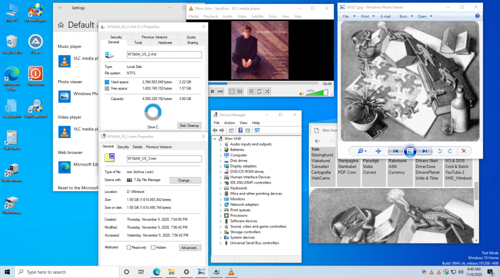

VHD_WIMBOOT has RAMDISK Option to Create Dynamically Expanding VHD files which are useful for fast loading into RAM Sparse files are less compatible for booting as VHD and can loose sparse attribute on copy. To boot VHD as FILEDISK you can simply use the Captured WimBoot LZX WIM file to Apply in Compact LZX mode on New Created Fixed VHD of Size 3.9 GB Fixed VHD has the advantage that it does not result in fragmentation of the VHD file when more internal space is used. 3. Mount VHD with doubble-click and use Win_Reduce_Trusted on Offline Windows - Reduce in 30 seconds gives Mini 10x64 VHD UsedSize = 1.79 GB - Capture WimBoot LZX WIM = 1.19 GB and Apply Compact LZX in 3.9 GB VHD
Apply WIM in Compact LZX mode gives VHD that boots independent of WIM Apply WIM in WimBoot mode gives VHD with pointers to the non variable files in the WIM archive. VHD and WIM are coupled and both needed to boot. Did you Apply WIM in Compact LZX mode in case of your final result with Used Size 907 MB ? What is the Size of your WIM file ? You used Virtual Box for that case ? After Win_Reduce_Trusted then the Captured WimBoot LZX WIM file is very small e.g. WIM Size = 1.19 GB Then you can Apply WIM in Compact LZX mode in new Expandable VHD size 3.9 GB suitable for booting Mini10x64 VHD from RAMDISK without needing WIM file. Booting from RAMDISK requires in advance to Install special SVBus driver and booting from RAMDISK is in MBR mode only using Grub4dos Menu. More Info: VHD_WIMBOOT.pdf
The WIM file is an install.wim file suitable for Apply and is not a bootable WIM file like boot.wim of Win10XPE Also for making Mini10x64.vhd remember to follow: 1. WinNTSetup - Fresh Install in 25 GB VHD using Win10x64 ISO from TechBench 2. VHD_WIMBOOT - Capture WimBoot LZX and Apply in Compact LZX mode in VHD 3. Mount VHD with doubble-click and use Win_Reduce_Trusted on Offline Windows - Reduce in 30 seconds gives Mini 10x64 VHD UsedSize = 1.79 GB - Capture WimBoot LZX WIM = 1.19 GB and Apply Compact LZX in 3.9 GB VHD 4. Boot with 3.9 GB VHD - Always use the supplied Firewall App Blocker and Enable WhiteList to Allow Internet Browser only - This is the easiest way to block unwanted internet traffic including Windows Update and prevents the growth of Used Size inside VHD You have finished now Step 1 and 2 Now it is time for Step 3 and 4

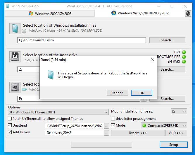

Don't use Virtualbox, it is nowhere stated to do so .... Before Step 2. you need to do Step 1. 1. WinNTSetup do Fresh Install Compact 4K mode of Win10x64 in 25 GB VHD located on Internal System Drive C: - use page 2 of this Manual Create the VHD in root of your normal Win10x64 drive C: e.g. VHD is C:\Win10x64.vhd Yes you can boot from internal SSD with VHD created next to your normal operating system. You get Windows Boot Manager multiboot menu.
WinNTSetup will auto mount boot partition as Drive Z: So can you boot now with VHD to Install Windows 10x64 in VHD ?
Nowhere in the Manual is stated that you should mount Boot partition as A: You must not mount Boot partition. WinNTSetup will auto mount the Boot partition as Z: WinNTSetup will auto mount created VHD as Drive Y:
