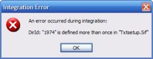

NeverGone Posted March 8, 2008 Share Posted March 8, 2008 What is it?I've got this error when I integrated WMP11 using nLite.Here is TXTSETUP:TXTSETUP.rar Link to comment Share on other sites More sharing options...
n7Epsilon Posted March 8, 2008 Share Posted March 8, 2008 This is not a bug in the slipstreamer, it is a problem with your source:From your txtsetup.sif:...1974 = "system32\en-US"1974 = "system32\ru-ru"...It seems that you integrated ie7 twice, once in english and another in russian. or you integrated ie7 on a source in which ie7 was previously added with nLite. Start over with a clean source. This one will not work. Link to comment Share on other sites More sharing options...
