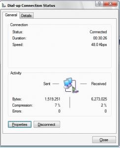

RJARRRPCGP Posted October 13, 2006 Posted October 13, 2006 (edited) You may still be at a slower speed! For me, even when Windows reports 48.0 kbps, I usually at 40 kbps. When I run download tests from various web sites and listen to streaming music, I'm at 40 kbps. I can't choose a 48 kbps file, because it will cut out and go into a rebuffering loop! Is there anything else I should try to get it at a true 48 kbps? It seems that I'm capable of going faster, even where I live, but it won't stay there!Before I bother with moving again? Edited October 13, 2006 by RJARRRPCGP
