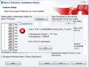

Anyhow, before I go claiming any credit and posting my modified version of the script, I have just run into a problem with the latest script posted by you. During the install the following error message comes up:
I don't think that the error is related to anything that I have added, although I may be wrong. Since, like I said earlier I don't know too much about scripting. But while going thru the script in trying to figure out if there was something I did to cause the error, I think I may have identified the problem in the script.
It seems that the following typo may be the problem:
; De-Select Nero Recode
If StringUpper( $Opt6 = ) "N" Then <--- THE LINE WITH THE POSSIBLE TYPO
Sleep( $DelayTime )
MouseClick ( "left" , 62 , 222 , 1 , 1 )
MouseClick ( "left" , 62 , 286 , 1 , 1 )
EndIf
Based on what I have observed in the rest of the script, shouldn't the code read like this?
If StringUpper( $Opt6 ) = "N" Then <--- THE LINE WITH THE POSSIBLE TYPO
Sleep( $DelayTime )
EndIf

Same here, yes that will do it just move the = to sort it.
Cheers
MC.

I edited the offending typo and tried the script again. The problem seems to be solved and there are no more errors. Also the whole install went smoothly and everything seems to be in perfect order so far.
I am attaching the final script, which has some small contributions from me.
