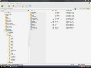

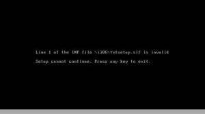

Kiki Burgh Posted May 2, 2006 Posted May 2, 2006 (edited) hi all!been away for quite a while ... ;(just wanted to share that all seems fine with those that i have slipstreamed ...only a few things to share though:888111 doesn't seem to recognized when ITs presence is validated via qfecheck ... it does not show in the reporta particular theme addon (VistaCGI if i recall it right) from rynavm prevent the OS from installing ... it shows that line 1 of textsetup.sif is not valid ...there seems to many directories (usually the very 1st folders) added to my i386 directory (i.e., 041, 043, & the like) ... where did these come from?btw, XPIZESW=/S /notask still didn't work for me. XPize installation still showed up at T-13 & i still followed the prompts.may i just ask what the SW is for? thanks! Edited May 2, 2006 by Kiki Burgh
tommyp Posted May 2, 2006 Posted May 2, 2006 @dziubek - What you are seeing is some LFN in your svcpack directory. It either got there from your HFSVCPACK directory or a non-compliant ryanvm addon. If you are running installation via CD, there is NO NEED to worry about this error message. The only way you will get errors is if you are running a dos prompt install (e.g. winnt.exe). @kiki - Do you get the same folder problem if you are not using application add-ons?

Tomcat76 Posted May 3, 2006 Author Posted May 3, 2006 @Kiki: Themes_rytukz_VistaCG_addon_v1.0.cab (and other addons of that type) should be supported with 60503a... @TAiN: You mean that one reference to the HFSVPK folder? Updated.

Kiki Burgh Posted May 3, 2006 Posted May 3, 2006 (edited) @kiki - Do you get the same folder problem if you are not using application add-ons?I have not added much add-ons except for the ff: VistaCG Theme [v0.98], Microsoft MakeCab v1.00.0601, XnView Complete v1.82.4, Reboot Into Safe Mode v1.0 ... please see the pic attachment for the extra foldersKiki - the SW in XPIZESW just means "switches", like in CDIMGSW and MKISSW (isoconf.txt).thanks for the clarification Super-Magician … I was just thinking that replacing it probably with .exe would make it work888111 doesn't seem to recognized when ITs presence is validated via qfecheck ... it does not show in the reportIs qfecheck capable of detecting it? As far as I know, it is only installed if Windows setup thinks it's necessary. It's just a driver update. Are you having audio problems?If installed separately, High Def Audio shows up in Add-Remove programs list … if included in the HF dir, it doesn’t show when checked via qfe … Please know though that I‘m not having any issue w/ audiobtw, XPIZESW=/S /notask still didn't work for me. XPize installation still showed up at T-13 & i still followed the prompts.Really strange. SVCPACK.INF doesn't contain the switches even though they are specified in XPize.txt. Can I have a look at your xpize.txt file?pls see attachments sir … I’ve included both the SVCPAK & SYSOC.infs … please know I am not having problems w/ the installation … it’s just that I hope I wouldn’t have to answer follow the prompts anymore at T-13@Kiki: Themes_rytukz_VistaCG_addon_v1.0.cab (and other addons of that type) should be supported with 60503a... got the latest already … let me try this ver Jjust the same pls see the pic attachment for the errorthanks guys! this is nothing much ... but may be worth a look ..."Founding" xpize.txtinfs.7z Edited May 3, 2006 by Kiki Burgh
Tomcat76 Posted May 3, 2006 Author Posted May 3, 2006 @Kiki60503b fixes the XPize problem. I also added something that alerts you which hotfix adds those extra folders. Please let me know which one it is.When you install KB888111 by hand, Windows assumes that you need it. I'll search around to see if it's really better to have Windows force-install it from SVCPACK.Everything should be fine with VistaCG (only checked version 1.0). I'll check the other addons you mentioned.this is nothing much ... but may be worth a look ..."Founding" Yeah... That's why CounterStrike isn't made for DOS...
Tomcat76 Posted May 3, 2006 Author Posted May 3, 2006 @KikiI had a look at the other addons you mentioned (except Microsoft MakeCab v1.00.0601 which doesn't seem to be available anymore) and don't see a problem. Please use the latest test release (60503c at the moment). If you still get an error referring to "line 1" of TXTSETUP.SIF, I'll have to take a look at your TXTSETUP.SIF file.

Kiki Burgh Posted May 4, 2006 Posted May 4, 2006 (edited) @KikiI had a look at the other addons you mentioned (except Microsoft MakeCab v1.00.0601 which doesn't seem to be available anymore) and don't see a problem. Please use the latest test release (60503c at the moment). If you still get an error referring to "line 1" of TXTSETUP.SIF, I'll have to take a look at your TXTSETUP.SIF file.thanks TC!as always, i have downloaded the latest! sir, do you mind looking into this: http://users.atw.hu/mp-soft/CabSDKAddons_1.0.cab?i've taken the liberty of attaching a zipped sif files (1 without the error & 1 with the error) for your referencejust wondering, for XPize to be silently install would i not need an edited modified SFC_OS.DLL which i got from http://www3.sympatico.ca/lazimute/xpcr_en/SFC_OS.DL_? thanks again!TXTSETUP.zip Edited May 4, 2006 by Kiki Burgh
