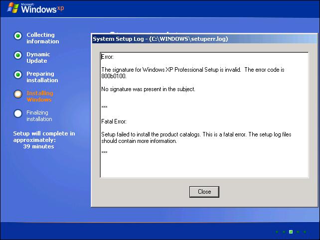

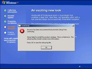

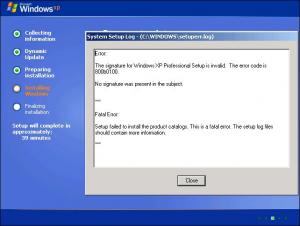

Kiki Burgh Posted June 5, 2006 Posted June 5, 2006 (edited) hi!i encountered these errors after using the hfcleanup for XP SP2:i tried using it via nLite too to remove some items but upon hitting the GUI, i got this something like: "DOSNET.INF not found"(i created isos via HFSLIP (1 with CAT files while the other 1 without) & created another iso via nLite to further remove a few more components) ... basically w/ the same results ...pls advise.thanks!HFSLIP.txt Edited June 5, 2006 by Kiki Burgh
