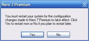

It seems that it installed nero, but at the end it asks to reboot.

i tried that. i opened the installer with winrar, saw that it was really little more than an sfx archive. i changed the command line to what you suggest, but it still asks for a restart and doesnt create any icons. at least for me.
