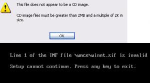

Arizon Posted May 24, 2005 Share Posted May 24, 2005 I have created with EasyBoot ISO file with Windows XP, Knoppix, Partition Magic 8 and it works. File is 1,20GB large so I put in EasyBoot\disk1\ folder named "Programs" and fill it with various programs so that I can get full DVD of >4GB. Make another ISO file 4,02GB large but Windows XP instalation won't work. Without "Programs" folder it works.Why it wont work with that folder and how to burn DVD with folder "Programs"? Link to comment Share on other sites More sharing options...
getwired Posted May 24, 2005 Share Posted May 24, 2005 What is the exact path of Programs on the DVD?What is the error you get when booting? Link to comment Share on other sites More sharing options...
Siginet Posted May 24, 2005 Share Posted May 24, 2005 May be bad media. I have had issues like this where if I only use a portion of the disk it works allright but when I use most of the disk it doesn't work. Try burning the disk slower... or different media. I wouldn't think adding a Programs directory to a good disk would cause a problem... unless I'm missing something. Link to comment Share on other sites More sharing options...
getwired Posted May 24, 2005 Share Posted May 24, 2005 There is indeed a scenario where this can caus this problem. And it totally depends on where those 4GB of files are sitting. Link to comment Share on other sites More sharing options...
Arizon Posted May 25, 2005 Author Share Posted May 25, 2005 It's not a problem with a media.When I tried with VirtualPC I've becomed the same problem as I burn DVD.With EasyBoot I've made Boot.iso and works perfect. Then I put folder Programs so it look like thisC:\EasyBoot\disk1\boot \ezboot \KNOPPIX \wmce... and it works fine, \PROGRAMS (when I put this folder, I get this:) Link to comment Share on other sites More sharing options...

BrandonS_Mil Posted May 30, 2005 Share Posted May 30, 2005 I think have the solution to your problem, my friend....In earlier posts...http://www.msfn.org/board/lofiversion/index.php/t44698.html i had boot problems with Virtual PC, VERY Little help.... Untill one day someone mentioned about Deamon Tools... I think you know him.... Alanoll ....I made deamon tools grap the ISO, then told VPC to use physical drive... works great.Now, just so i make myself clear.... I HAVE NOT TRYED THIS ON A ISO LARGER THAN 4GB.If this does work, that will help me out too.... Please let me know. Link to comment Share on other sites More sharing options...
Alanoll Posted May 30, 2005 Share Posted May 30, 2005 I've made an ISO file that bumps right at the 4.37 gig barrier without any problems.The problems that may occur is it's a simulation are:1. Wrong File System. Joliet and UDF are best, however only Joliet is a bootable type.2. You recieve teh VirtualPC error of the 2MB or 2K multiple thing which is fixed by using a virtual CDrom and have VirtualPC grab that. Daemon Tools is just the freeware alternative then Alcohol 120%, but both work just the same.To completely avoid this issue, would be to use VMWare as it doesn't have the error.If it's physical medium:1. File System like mentioned above.2. Bad media3. Burner error. Try burning at a slower speed if possible. Perhaps even a firmware upgrade may solve the problem. Link to comment Share on other sites More sharing options...
getwired Posted May 30, 2005 Share Posted May 30, 2005 The error you are seeing is virtual PC's ineptitude at dealing with images of "CD's" that aren't CD's. In the case of booting Windows CD's or WinPE CD's, depending on what ISO creator you use there is a different error you can hit at boot time. Link to comment Share on other sites More sharing options...
dougiefresh Posted June 5, 2005 Share Posted June 5, 2005 I've heard that Virtual PC does not deal with ISO images that are greater that 2 GB in size. Maybe if you try Alcohol 120% to mount the ISO, then run Virtual PC and instruct it to use the virtual DVD drive, maybe you will have more success. Link to comment Share on other sites More sharing options...
Arizon Posted June 12, 2005 Author Share Posted June 12, 2005 First you have to mount ISO image into a physical drive and then start Virtual PC. Then it works! Link to comment Share on other sites More sharing options...
