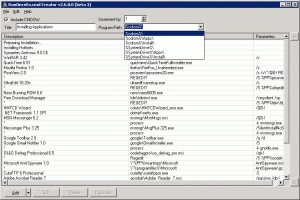

echap2000 Posted February 27, 2005 Author Posted February 27, 2005 I don't understand what do you mean by "drop down panel" ? a combobox ??can you illustrate it?
`Felix` Posted February 28, 2005 Posted February 28, 2005 I don't understand what do you mean by "drop down panel" ? a combobox ??can you illustrate it?<{POST_SNAPBACK}>Yes no problems Attached screenshotAlso attachment 2 may give an idea of an easy way to order the list quickly
