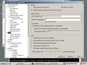

Step 1: first switch ur user interface to columns ui by going to preferences then go to Display. In the display window click the dropdown combo box and select columns ui. Restart foobar2000. (see screenshot below)
Step 2: load foobar2000. go to preferences click columns ui. next click on the other tab.
Step 3: in the other tab window click import and browser to columns_ui_configs under the components sub directory under foobar2000's directory. Select a config file and load it. Click the check box next to custom buttons. Then click the button with "..." on it and browse to buttons sub directory under components directory. Restart foobar2000 and enjoy. If anyone finds this too complex, I will make an instructions pack and post it if necessary.
