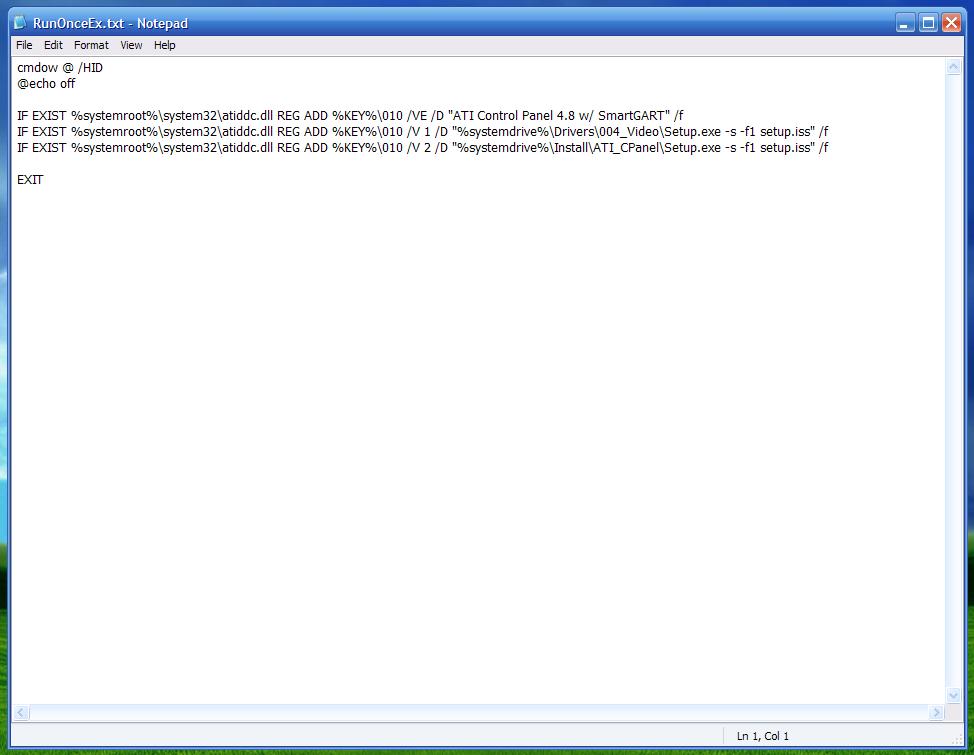

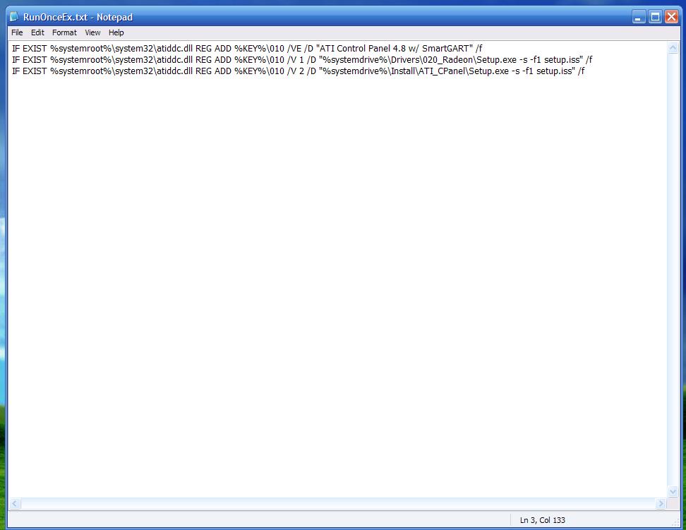

Is this how my batch file should look? I only plan on installing the ATI driver for my unattended. Does it work with 4.8 drivers on SP2?
That syntax is meant to be used with RunOnceEx as outlined here: http://unattended.msfn.org/xp/runonceex.htm
If you're using a different batch, then you should use:
IF EXIST %systemroot%\system32\atiddc.dll %systemdrive%\Drivers\020_Radeon\Setup.exe -s -f1 setup.iss
IF EXIST %systemroot%\system32\atiddc.dll %systemdrive%\Install\ATI_CPanel\Setup.exe -s -f1 setup.iss

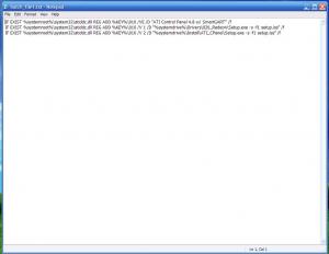

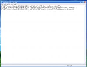

ok, so i put the runonceex in my cmdlines.txt. i made a runonceex. is this how it should look? or is there some more stuff i should have in it?
you need a couple lines after @echo off
SET KEY=HKLM\SOFTWARE\Microsoft\Windows\CurrentVersion\RunOnceEx
REG ADD %KEY% /V TITLE /D "Installing Applications" /f
the first one sets the %KEY% variable, which is used in every subsequent line in the file. second line sets the Title of the RunOnceEx window and can be whatever you want (change the words in the quotes)
also you shouldn't have cmdow @ /HID in your batch file unless you have the cmdow file in your $OEM$\$$\System32 folder. I don't know if you read that part of the tutorial.
yeah i do have the cmdow in my system32. i did read that part, but thanks anyways!
