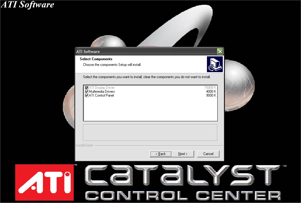

and for the new Control Center, I'm sure the installer won't complete on a system without an appropriate card, however, It'd be nice to avoid it running at all when it's not needed.
It doesn't run, doesn't even show up in the selection unless the appropiate card is detected in the installation. See pic below.
