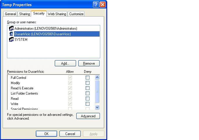

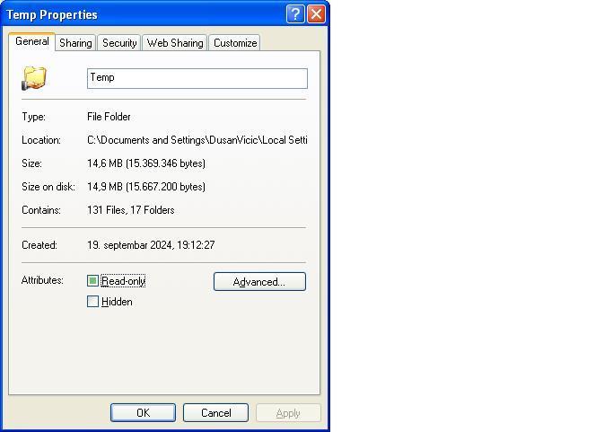

Dušan Vićić Posted September 22, 2024 Author Posted September 22, 2024 (edited) I've just realized that I've probably found the problem.... On Visual C++ 2010 it says: The Temp folder is on a drive that is full or is inaccessible. Free up space on the drive of verify that <b> you have write permission on the TEMP folder </b>. So, i started looking up around %temp% folder. It's read-only. Plus, i think i've found another problem. When you have to enable Security options on the folder, you must go to Folder options and uncheck Use simple file sharing (Recommended). Now the tricky part is that on any folder on the second and third partition of the HDD it shows the Security tab when i click Properties. BUT NOT ON THE C:\ FOLDER! Including the %TEMP% folder. Any ideas? Edited September 22, 2024 by Dušan Vićić

Dušan Vićić Posted September 23, 2024 Author Posted September 23, 2024 (edited) On 9/22/2024 at 11:59 PM, Dave-H said: Should do, yes. I have drives on my multi-boot system which I keep on FAT32 for compatibility with Windows 98! So, i converted the FAT32 into NTFS. Then i checked ownership, and as I've thought, it was set not to my username, DusanVicic, but to Administrators (it is hidden, accessible only though Safe Mode i think). I transferred ownership from Administrators to DusanVicic, and with 4 or 5 folder restriction errors, everything was changed to my user. I tried to run Visual C++ 2010, and... nope. I still have that error... The only problem remaining is the read only attribute. When i tried to uncheck it, it's only showing that it is unchecked until i close the properties, the next time i open it, it comes back as checked. How to make it permanent? Edited September 29, 2024 by Dušan Vićić Fixed some things...
Dave-H Posted September 24, 2024 Posted September 24, 2024 FWIW my Windows temporary folder is also marked as read only, so I don't think that's your problem. If your temporary folder really was unwritable you'd be having a lot more issues, as many programs need to write to it all the time, including Windows itself.
