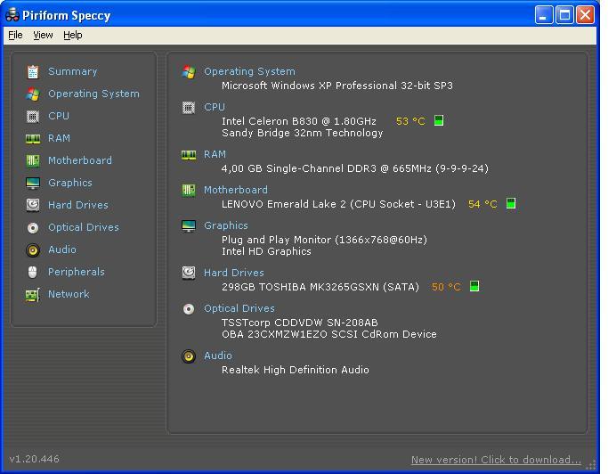

So I've decided to finally try to install Windows XP on Lenovo G580.
Because i had some problems with newer software, i had to do via WINSetupfromUSB. Figured it out second time by pressing F6 and installing SATA/AHCI Intel drivers.
For triple boot, i'm planning to use 3 partitions.
1st is 32GB FAT32 for XP (compatibility), other two are NTFS for Windows 7 and for trying the 10.
Drivers were a bit of pain to install, but i did it with other ways.

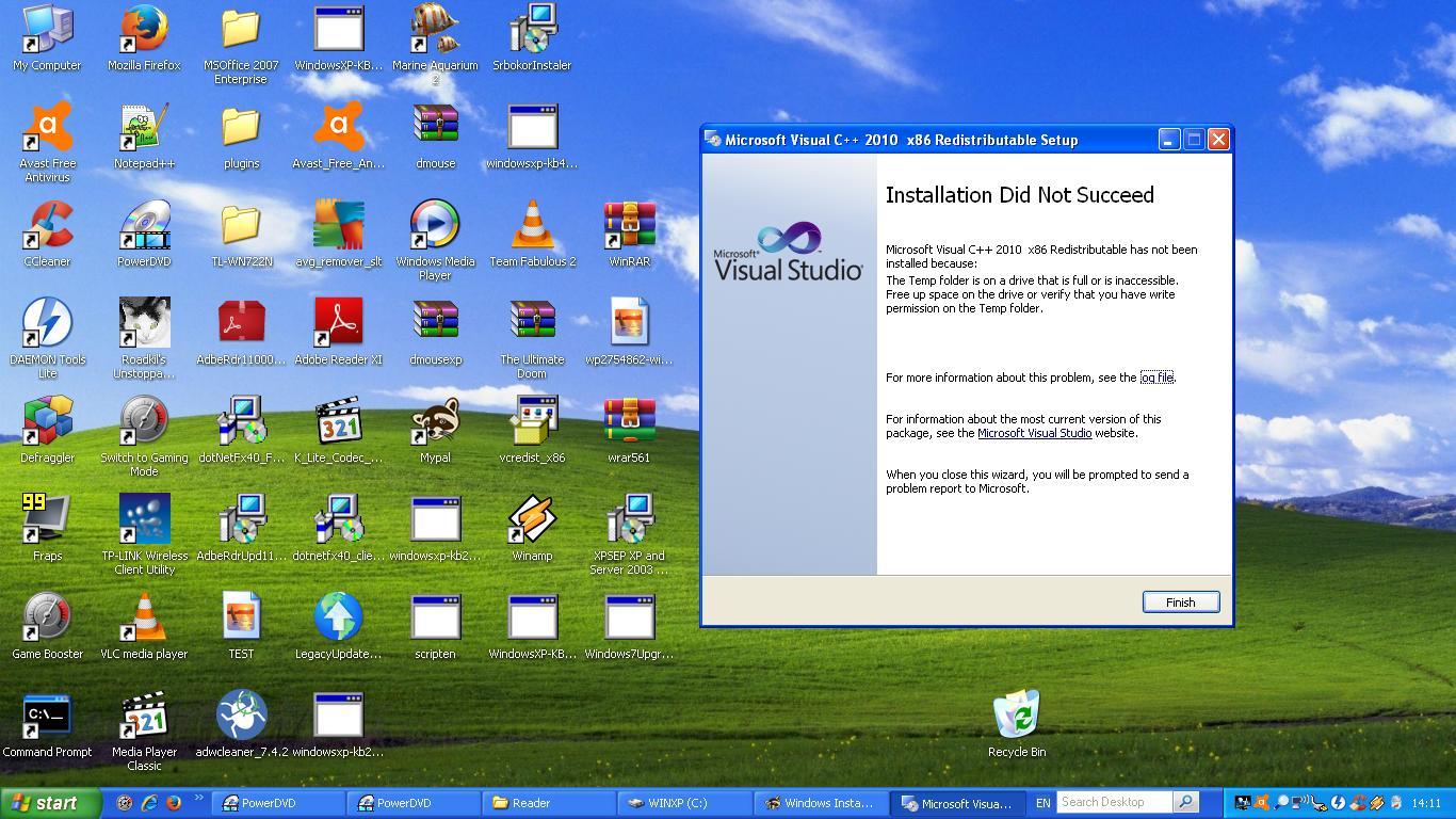

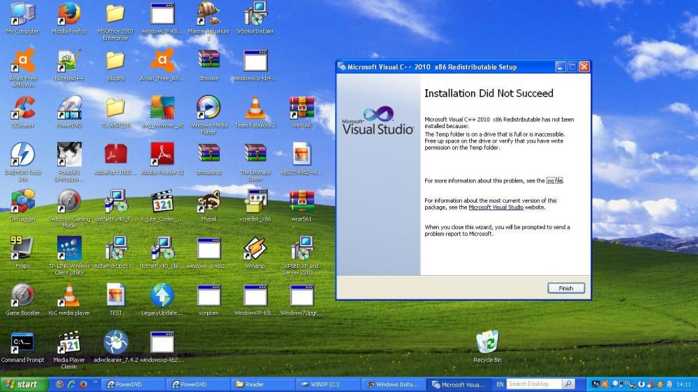

Problem is that when i tried to install Visual C++ 2010 Redist, i found out about this error written on the title of the thread.

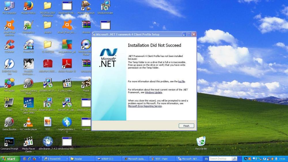

Then it happened again when i tried to install Office 2007 Enterprise, ANY version of NET. Framework, Adobe Reader XI and some XPS Essentials pack. At least i have the wireless functionality enabled...
I think it looks like i have problems with folder permissions and the TEMP folder being full (it happens even after i run %TEMP% and empty the files in the folder), but i will say that i haven't installed all updates for SP3.

the lap-top "Lenovo G580" you described has sse but
or we talking about the specs you posted below ? "AMD Athlon 600 MHz" that one only got MMX
just to confirm are you talking about this one ? :
https://support.lenovo.com/us/en/solutions/pd025312-overview-lenovo-g580
YES, it is that same laptop. Celeron version... - _-

you wrote "Problem is that when i tried to install Visual C++ 2010 Redist"
but thats a own installer its called something like "vcredist_x86.exe"
but then in the screenshots you tryed to install some kind of the "dot.net framework 4 installers" later on "adobe reader xi"
that raise the question why you said the VC 2010 redist is the problem - while you tryed to install different things
while framework said the disc is full or inaccessable
adobe said something like it cant connect the update server (if i got this one it right)
there are installers need internet access

Yes, XP is 32bit, for your consideration, and i forgot that my Celeron on G580 supports 64bit...
I downloaded your version of 32bit NET. 4 Framework and it still showed that error.
And yes, Visual C++ 2010, Reader XI, Office 2007 and NET. 4 doesn't work at all...
I think it has to do with admin access thing... %TEMP% folder is clean tho... And yes, i have an DusanVicic admin username already...
Edited by Dušan Vićić
well it says check to free disc space
that´s an easy one
start -> my computer -> (rightclick local disc C:)) -> properties (free disc space)
for the permissions you look the folders if something is wrong
check all permissions

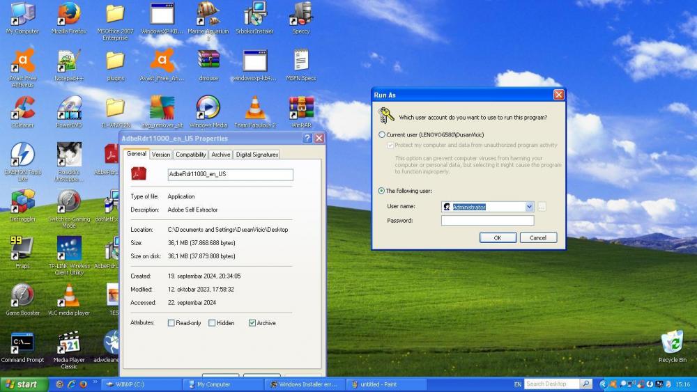

"All Users" describe you not logged as administrator
you can try "right click and start as administrator on one of these installers"
or you can change the user to administrator and see if the installation works there
that is somewhere start->Log Off where you can switch the user

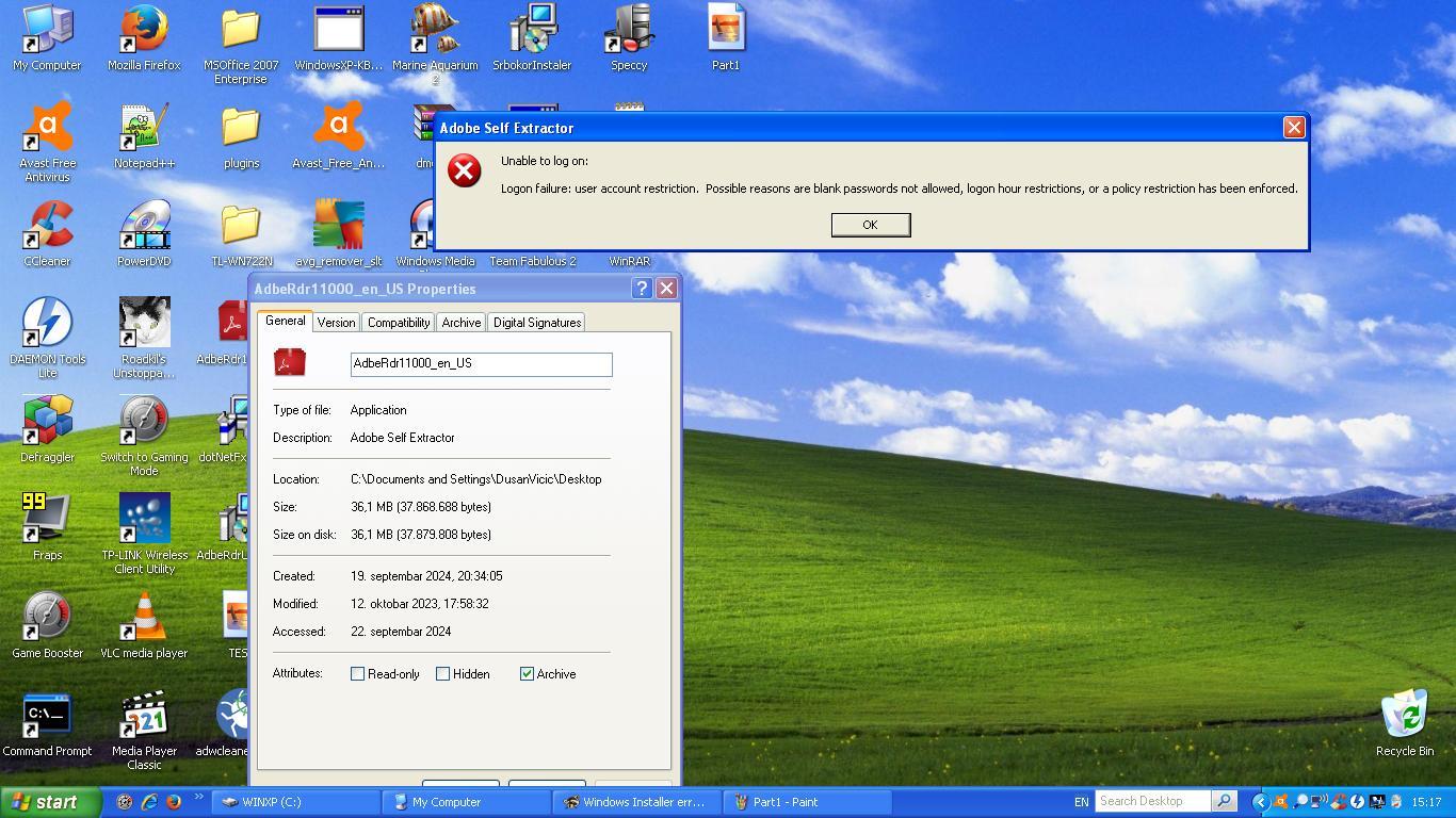

Added on Administrator and on DusanVicic full controls, restarted the system, AND started with admin rights the Reader XI setup.
Then this happens. Even though I've already got admin rights, and it was the first OS out of 7 and 10, shows this error...
Great, just great.... And it happens with other setups also.
