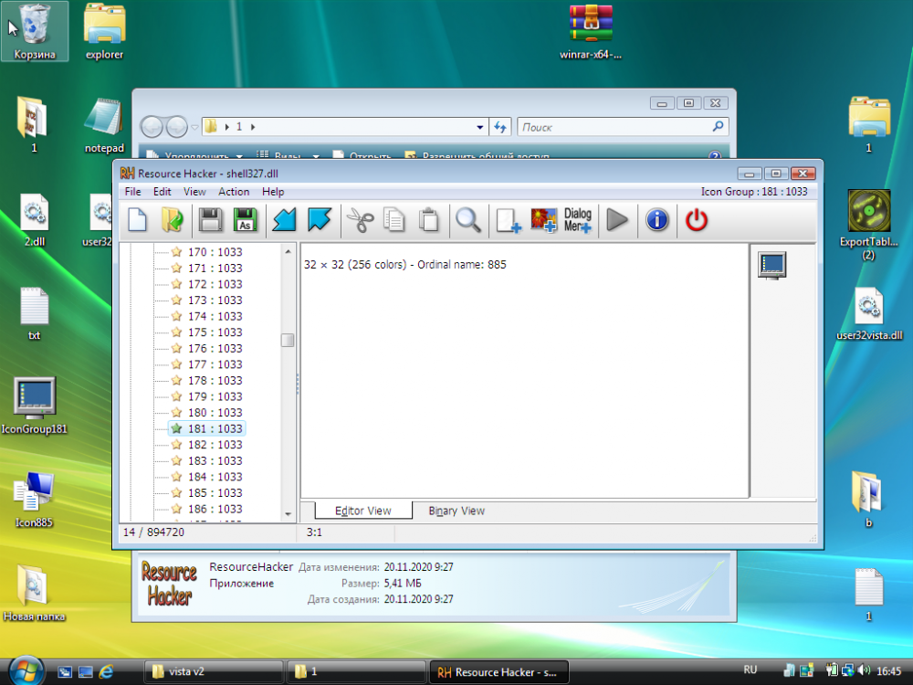

leo_vinso84 Posted September 5, 2022 Share Posted September 5, 2022 Hi guys, I'm making a port of the seven explorer on whist, but an error appeared, the serial number 885 was not found in the shell32 dll library, so who fumbles please answer. Link to comment Share on other sites More sharing options...

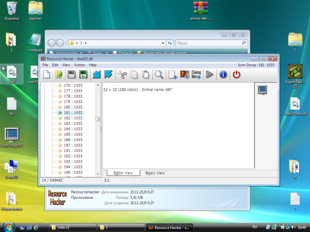

leo_vinso84 Posted October 24, 2022 Author Share Posted October 24, 2022 Hello again guys, I found out the problem so let's say 885 it is only what the problem itself is, it is designated differently, that is, instead of 885 it costs 687, there will be screenshots from below, if anyone can help with this problem I will be glad,where it says shell327 took it from Windows 7. Link to comment Share on other sites More sharing options...

j7n Posted October 24, 2022 Share Posted October 24, 2022 The ordinal in this case is a missing function of program code. You can see them in Dependency Walker. It has nothing to do with icons. I would either use WinSeven as it is if you like the revamped UI of Explorer, or another file manager of choice that works on any OS. Link to comment Share on other sites More sharing options...
leo_vinso84 Posted October 24, 2022 Author Share Posted October 24, 2022 33 minutes ago, j7n said: Порядковый номер в данном случае является отсутствующей функцией программного кода. Вы можете увидеть их в Dependency Walker. К иконам отношения не имеет. Я бы либо использовал WinSeven как есть, если вам нравится обновленный пользовательский интерфейс Проводника, либо другой файловый менеджер, который работает на любой ОС. Thanks, I'll check there. Link to comment Share on other sites More sharing options...
leo_vinso84 Posted October 24, 2022 Author Share Posted October 24, 2022 (edited) 6 hours ago, j7n said: Порядковый номер в данном случае является отсутствующей функцией программного кода. Вы можете увидеть их в Dependency Walker. К иконам отношения не имеет. Я бы либо использовал WinSeven как есть, если вам нравится обновленный пользовательский интерфейс Проводника, либо другой файловый менеджер, который работает на любой ОС. I looked there is no function there through this program PS. Everything has already been fixed now explorerframe error Edited October 24, 2022 by leo_vinso84 Link to comment Share on other sites More sharing options...
