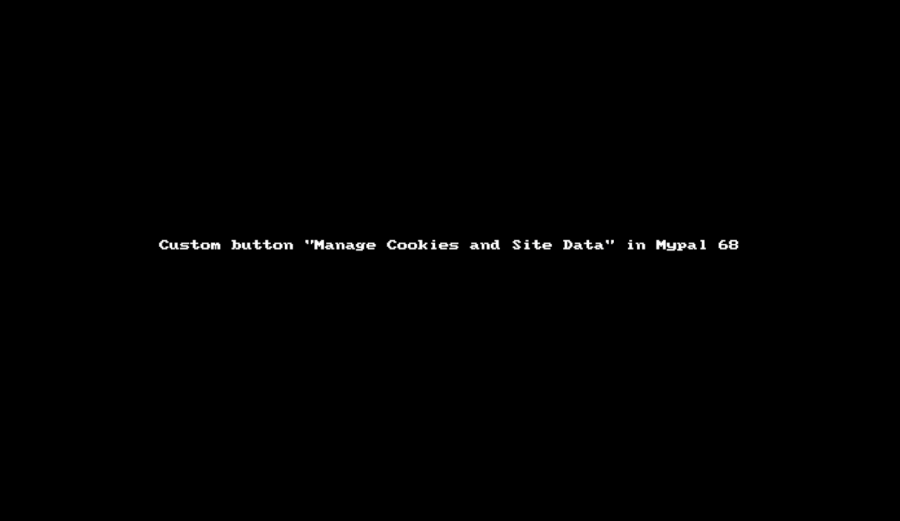

AstroSkipper Posted October 25, 2024 Author Posted October 25, 2024 (edited) 21 hours ago, AstroSkipper said: As custom buttons are actually the topic of this thread, I have decided to post about this stuff here again. My project of creating a custom button to directly call up the "Manage Cookies and Site Data" dialogue in Mypal 68 seems to have come to a temporary end. It works perfectly. I have solved the issues encountered in my own way and I am currently in testing mode. Here is a short preview: Perhaps, someone is now wondering what is so special about the "Manage Cookies and Site Data" custom button. The answer is quite simple. There is no functioning extension or toolbar button for the Quantum browser Mypal 68 that can simply call up the native, internal cookie manager only. In contrast to the UXP browsers, the direct call of the corresponding XUL file is unfortunately no longer sufficient because it doesn't work correctly. Call it a bug, an issue or whatever, in any case, it is faulty. This custom button seems to be therefore unique. Contrary to the native popup, to which you first have to click through, It calls up the internal cookie manager by only one click in an own, resizable window. BTW, creating custom buttons for UXP browsers is much easier and much more fun. In the Quantum browser Mypal 68, most things no longer work as easily or at all. Everything is very restrictive and obstructed. Edited October 25, 2024 by AstroSkipper Update of content 5

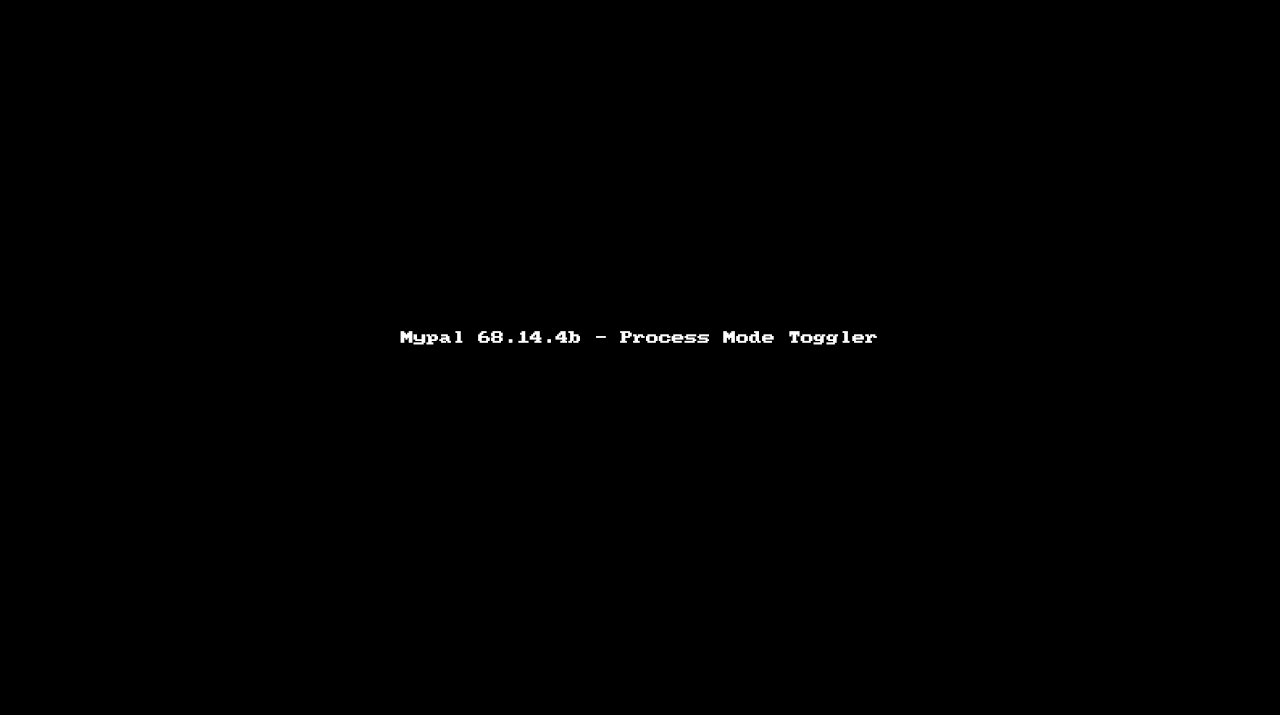

AstroSkipper Posted November 24, 2024 Author Posted November 24, 2024 I think it is well known by now that I am a fan of custom buttons. The last months, I created a couple of them for the UXP browsers as well for Mypal 68. Here is one of my latest creations: 5

AstroSkipper Posted November 25, 2024 Author Posted November 25, 2024 (edited) 14 hours ago, dmiranda said: Hi @Astroskipper. Where can we try these (two?) new buttons? Which two buttons? The clip is about one button, my recently created custom button called Process Mode Toggler. You won't find it anywhere. However, I have recently posted some new custom buttons for UXP browsers and compatibles in my thread "Extensions and custom buttons for UXP browsers - Corrections, modifications, adjustments, and special recommendations". Given the lack of response and interest, I doubt that the Custom Buttons extension is used very much in general by our members or readers for whatever reasons which I do not really have to understand, though. And with a probability bordering on certainty even much less in Mypal 68 if at all. TBH, I am beginning to think I am the only one using the legacy Custom Buttons extension in Mypal 68. Anyway! I developed the Process Mode Toggler custom button actually for personal use in Mypal 68 to test UC.JS scripts, CSS stylesheets, extensions and legacy custom buttons conveniently and quickly in multiprocess mode as well in single-process mode. Especially to test my self-created ones. If there was genuine interest in my custom buttons and it was communicated in this way, then things would be different. But I can't see that so far. The clip I have posted should simply give you an impression of what I do with custom buttons and what can be done at all. No more, no less. Edited November 25, 2024 by AstroSkipper Update of content 5
AstroSkipper Posted November 25, 2024 Author Posted November 25, 2024 (edited) The last months, I have deepened my knowledge about JavaScript and CSS. In the case of the Process Mode Toggler custom button, one might think that it only toggles the browser.tabs.remote.autostart preference. However, this is not the case. Besides toggling this preference, my custom button displays the current process mode via toolbar icon and tooltip. It doesn't matter whether the button was used for toggling the process mode or not. It always recognises the correct mode. The process mode change is linked to a restart of the browser which is of course necessary for running the browser in the new mode. Additionally, it also adjusts two other prefs that are related to the respective process mode: dom.ipc.processCount and dom.ipc.processCount.webLargeAllocation. Their values can be preset for the respective process mode in the first lines of the button code. So, this custom button is very special and rather unique. In any case, one thing is clear. Webextensions are much more restricted and not allowed to control such features what in contrast UC.JS scripts and legacy custom buttons can easily do, though. Edited December 4, 2024 by AstroSkipper Update of content 5
