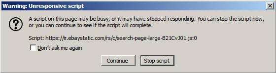

Okay, one more... Does anyone know how to get rid of unresponsive script errors on MyPal 14?
I keep getting the following error - and I'm not sure if there's a setting I should adjust to get rid of it.
I get these errors constantly on eBay, Amazon and YouTube.
Set both prefs dom.max_script_run_time and dom.max_ext_content_script_run_time to the value of 0 via about:config! :P
Thanks AstroSkipper - those unresponsive script errors are gone!

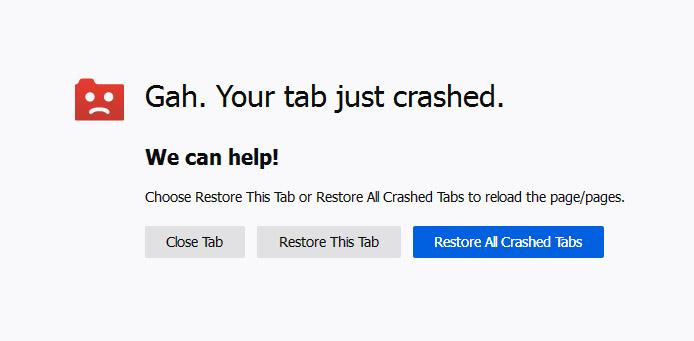

But now, I've started to get some new "tab crash" errors when I'm using eBay. They don't happen constantly - but they are cropping up.
What should I do? Adjust those values again?
No. Actually, these crashes can't be related to these two prefs settings. I use both for a longer time and didn't notice any tab crashes. TBH, I have never seen this messsge before. This must be caused by someting different. And the crappy eBay website doesn't work well in Mypal 68 for some time. I did an order on eBay yesterday using Mypal 68, and it wasn't a pleasure. You should use uBlock Origin in any case especially if accessing such bloated websites. Do you use Mypal 68 in single- or multi-process mode? Do you use a new, clean profile? :dubbio: Please provide more detailed information when posting issues! :)
What should I do?
Disable hardware acceleration as a test to see if eBay tabs still crash or not! Check all relevant settings regarding hardware acceleration in about:config! Especially media and codecs related ones. Tab crashes are very often related to the hardware acceleration as reported by users. Of course, there may also be other reasons. Check also your graphics card drivers and all related settings! Furthermore, try to block on eBay as much as possible by uBlock Origin! And provide your hardware specs regarding CPU, RAM and graphics card, and the used OS!
PS: All test should be done in a brand new and clean profile to ensure that the used profile isn't faulty.

The tab crashing seems to have gone away on eBay.com. (It only happened a few times.) If I run into it again, I'll try upgrading to the next version.

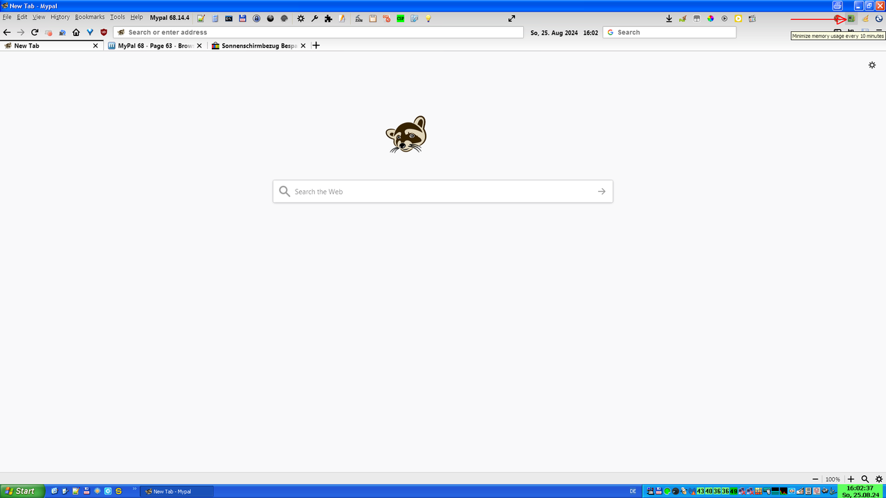

I already mentioned that I use a legacy custom button for this purpose which can be seen in the top right of my posted screenshot. I marked it with a red arrow.
On 8/25/2024 at 1:48 PM, AstroSkipper said:
As a further and quite effective measure, especially in multiprocess mode, I automatically perform every 10 minutes a memory minimization by a legacy custom button. :P
In this way, I free Mypal 68 from occupied RAM memory (and that's not even that little) that it does not want to release on its own, even though it no longer needs it.
In multiprocess mode, a not inconsiderable amount of wasted RAM memory can thus be reclaimed on a regular basis. This has already been tested by me. Therefore, I would like to see such a feature natively implemented in Mypal 68, as I described in my previous posts. :)
