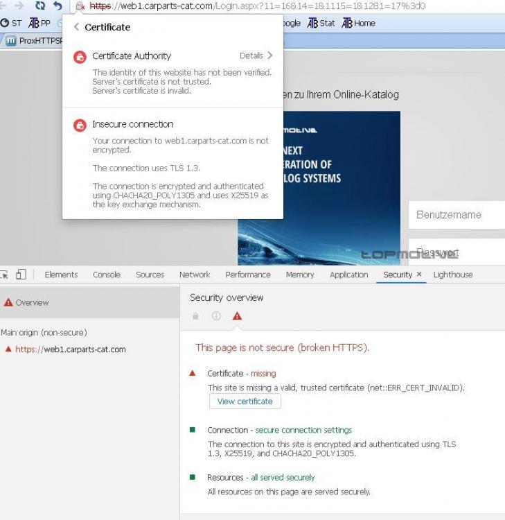

Anbima Posted May 24, 2024 Posted May 24, 2024 17 hours ago, VistaLover said: What does an XP SP3 x86 user see in the above scenario? FWIW, "http://web1.carparts-cat.com/" ALWAYS redirects to HTTPS here, so what makes one believe the connection succeeds but data is transferred unencrypted? It looks like this for me:
w2k4eva Posted May 25, 2024 Posted May 25, 2024 (edited) 16 hours ago, Anbima said: It looks like this for me: Does your chrome360 include the root cert ISRG Root X2 ??? This could be as a root cert, or in the older case it used to be an intermediate cert cross signed by ISRG Root X1, which in turn could have been either a root itself, or cross signed by DST Root CA X3. If that/those is missing you might have a problem... it DOES appear to be properly encrypted, just to a root cert that itself is not trusted. edit: you can download the cert from https://letsencrypt.org/certificates/ scroll down to "Root CAs", then "ISRG Root X2", then "Certificate details (self-signed)" choose your format, since I do not use chrome360 I'm not sure whether it prefers *.der or *.pem, someone on here who uses it can give better instructions on how to add it for your browser, or if it uses the system store Edited May 25, 2024 by w2k4eva add DL link
Anbima Posted May 25, 2024 Posted May 25, 2024 (edited) 6 hours ago, w2k4eva said: it DOES appear to be properly encrypted, just to a root cert that itself is not trusted. Does this mean that the data is transmitted encrypted? I was told in another thread that it's because 360Chrome Elliptic Curve key algorithm certificates are not compatible: https://msfn.org/board/topic/175170-root-certificates-and-revoked-certificates-for-windows-xp/page/41/ 6 hours ago, w2k4eva said: choose your format, since I do not use chrome360 I'm not sure whether it prefers *.der or *.pem, someone on here who uses it can give better instructions on how to add it for your browser, or if it uses the system store I've already done that too. This is displayed for me at the intermediate certification bodies. Maybe we can continue it in the other thread, where it fits better: https://msfn.org/board/topic/175170-root-certificates-and-revoked-certificates-for-windows-xp/page/41/ Edited May 25, 2024 by Anbima
w2k4eva Posted May 25, 2024 Posted May 25, 2024 5 hours ago, Anbima said: Maybe we can continue it in the other thread Seems this question could fit in any of 3 threads. Since the screenshots are already in this thread, I'll try here, though if forum admins ask and/or move the posts with screenshots I'll be happy to move there. But looking more at your previous screen shot, leaves me more confused too, it gives conflicting information. On the heading "Insecure connection" it says "Your connection to web1.carparts-cat.com is not encrypted" but 2 sentences later says the connection is encrypted, plus the "security overview" thing has the 2 items of green text saying ""the connection to the site is encrypted" and "All resources on this page are served securely" ... rather contradictory. Does anyone have access to source code for chrome360 who can tell us what this combination of messages might actually mean? Also from the previous screen shot, it says "Certificate - missing". Your second screen shot shows the ISRG Root X2 cert, but not as a root cert - that looks like the cross signed version (actually an intermediate cert, not a root cert), which depends on also having the X2 cert signed by the X1 cert. So, does your chrome360 have a root cert for ISRG Root X1 (probably listed on a different tab in the certificate manager, I don't really read German so can't suggest the tab title)? Part of the confusion is that there are multiple versions of these certs, having the same names. That's why I mentioned "Certificate details (self-signed)", it seems you have the cross signed version. If you need the X1 root cert, it can be downloaded from the same page I linked before (again, look for the "self signed" variant). So if that is present (as a root cert, it too has a cross signed intermediate form that would require yet another root cert that signed it), it might come down to whether chrome360 can handle the ECC type encryption, or if not, whether you can get the proxy to do that for you.
Anbima Posted May 26, 2024 Posted May 26, 2024 I am also surprised that it shows unencrypted and encrypted. Hence my question. X1 is listed among the trusted root certification authorities, even twice:
w2k4eva Posted May 27, 2024 Posted May 27, 2024 7 hours ago, Anbima said: X1 is listed among the trusted root certification authorities, even twice: Okay... it looks like that should have covered it in terms of having the certs. So what is left is whether chrome360 can handle the certs it has. Which is a different question than whether they are missing. For the two X1 root certs, are they indeed the same? Or does one use ECC type encryption while the other uses RSA? You would need to examine both of those certs in detail to see that. Could you look at which certs that site is actually using, and check each one in the chain to see if they are using the possibly problematic ECC versions? For some versions of some browsers, if a given website had multiple possible paths to chain to a trusted root cert, they would try the first path encountered and if that failed they would not try any of the other paths even if that would have worked if the first path tried had not been there. For that situation one would have to figure out the failing path and eliminate some certs so that path would not be possible, forcing the browser to use another path that would work. I do not know whether your version of chrome360 has this issue, or if eliminating such a duplicate path might help for your case. Some other users are posting screenshots of such ECC certs working in XP with MyPal, is trying that an option for you? Otherwise you are back to making the proxy handle it for chrome360, which does indeed belong in this thread.
