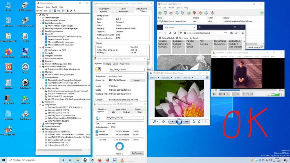

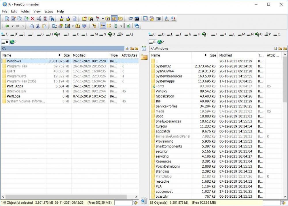

Mini-10x64 version 21H2 VHD has Compact LZX UsedSize 1.46 GB (running OS = 1.63 GB) with LZX WIM Size = 1.15 GB
My old Mini-10x64 of january 2021 has 24276 files and LZX UsedSize = 1.97 GB and  LZX WIM = 1.62 GB
Download File_List  - Mini_10x64_21H2.zip
Mini_10x64_21H2 has   18.806 Files and   3.031 Folders
Full   10x64  21H2 has 115.304 Files and 32.333 Folders
23745912_Mini_10x64_VHD_WinApps_2021-11-18060956.png.4076934be6153d15ce59a202fc0f5bcb.png   Mini_10x64_VHD_RAMDISK_2021-11-18.thumb.jpg.82ab9d5102a60e411e03234360f43cc5.jpg

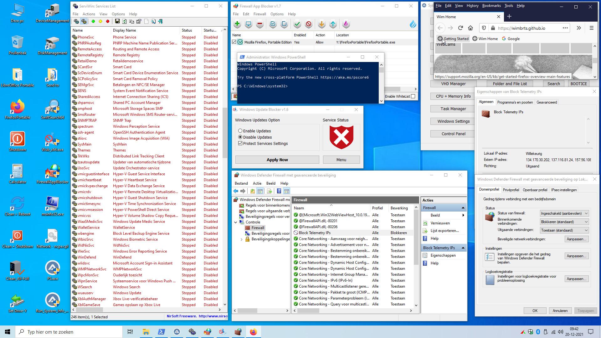

- Added Windows Update Blocker - Wub folder in \Add_Folders_Files\Port_Apps folder of Win_reduce
- Shortcut on Desktop to launch Wub_x64.exe added in \Add_to_UserPath\Desktop folder
- Shortcut on Desktop to launch Network - ncpa.cpl - Easy Switch On / Off Network Adapter
- PS.exe is running now as Admin so that all apps in PStart Menu are Running as Admin
- Added Run_System_Info_x64.exe in \Add_to_UserPath\Desktop folder
  Run_System_Info_x64.exe will Find and Run \System_Info\System_Info_x64.exe on Any Drive
  For this purpose your System_Info-53 folder must be in Root of Any Drive and must be Renamed as System_Info
First time you need to boot Mini-10x64.vhd as FILEDISK and be sure there is No Network Connection possible.
Then you need on Desktop launch Wub_x64.exe to Disable Windows Update and Protect this Setting.
It is now safe to connect to Network using Enable WhiteList Off setting in Firewall App Blocker.

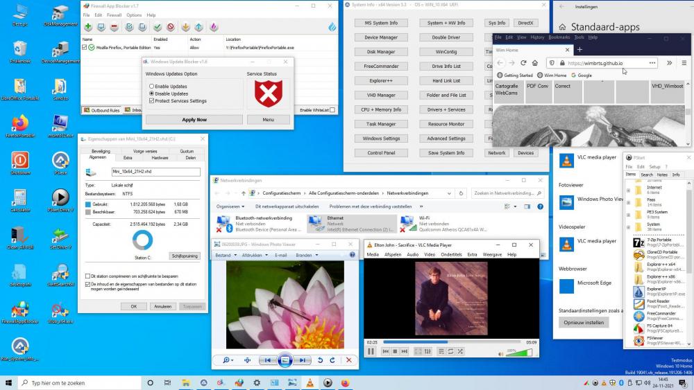

Boot Mini-10x64.vhd as FILEDISK or from RAMDISK and
Connect to Internet and FireFox pages appear OK without an increase of the Mini-10x64 UsedSize

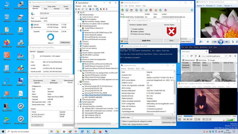

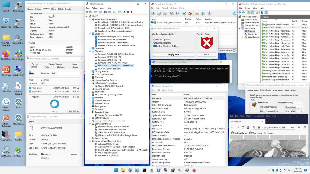

Mini-10x64_2021-11-24_144508.thumb.jpg.050eec39c6570ec435e0d7ddff2aaa1a.jpg   Win_Reduce_2021-11-25_191305.jpg.39a3c962b880e954798f790c69d727fe.jpg

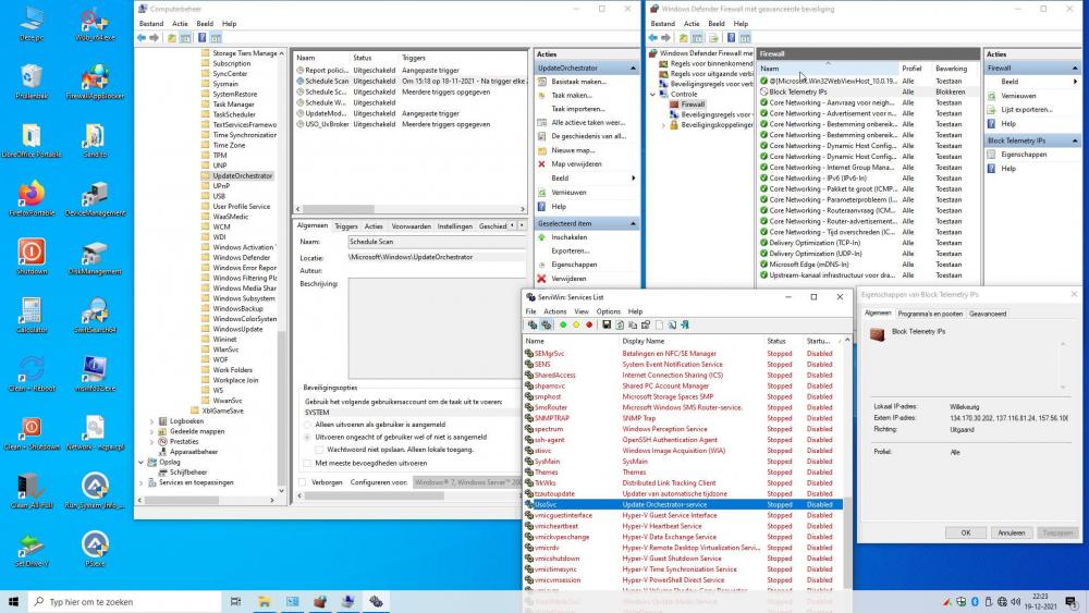

- Several times Press Enter key (First Click on OneDrive Remove Window) to let the Program Win_Debloat_x64 Continue
- it allows to view intermediate results and give instructions on How to Install Manually SVBus driver

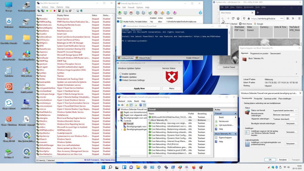

Windows Update Blocked and Defender Disabled, 51 Tasks and 67 Services are Disabled, WindowsApps Removed with Clean Start Menu
OneDrive Removed, Telemetry Blocked, SVBus Driver Installed for booting from RAMDISK, UsedSize Reduced to below 2 GB for Mini-10x64 OS in VHD
Win_Debloat_2021-12-16_155422.jpg.966fbc5494af0133518ca4066ff084e4.jpg    Win_Reduce_2021-11-25_191305.jpg.e456fb35286842fed5d58b7c0a9a8147.jpg    VHD_WIMBOOT_2021-12-21_100603.jpg.87fd1e4d21b580139439bc73a4533b1d.jpg
Mini-10x64_2021-12-19_222319.thumb.jpg.7a5ede4ea129a6732014d456db9069cd.jpg    Mini-10x64_2021-12-20_094223.thumb.jpg.5144d44a678e3f63aa7203622fd182c8.jpg
Mini-11x64_2021-12-20_100053.thumb.jpg.c1aa71b2f7aecb1011f10ada2b164ba2.jpg    Mini-10x64_RAMDISK_2021-12-20_133321.thumb.jpg.c569d5c6273a2e435c9165127de8489c.jpg
