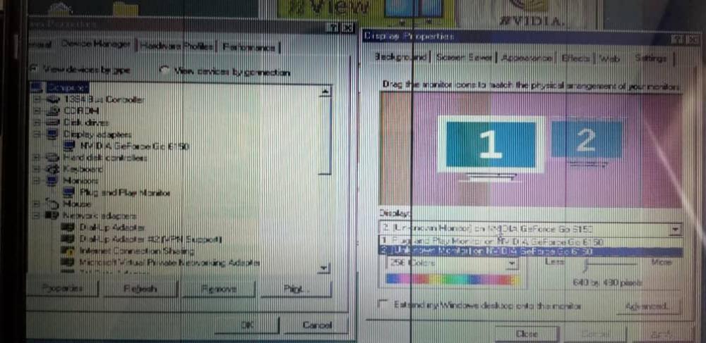

Hi, sorry to bother here again. I got a DV9000 with a Geforce Go 6150, I used the NVIDIA Display Driver 82.69 which they did install. After a reboot, I removed the current display driver which did not detect and updated the driver from the TEMP folder created from the installation. After reboot it did detect the card and rebooted again. After that It shows the NVIdia Tray icon but it doesn't display correctly. I'm not sure if it is a Monitor problem or a driver problem.
Also I couldnt install the drivers 81.98 saying "Setup was unable to locate a detected device's PCI ID in NVAGP.INF"
Any ideas on how can I correctly get my display working? And thanks a lot for any help.

Low resolution, 16 colors?
Try to start the NVidia control panel applet. Or check for NVidia tab in Display properties. Does it show your GPU model or any other info?
Check the driver properties in Device manager. Any errors there? What type of monitor is shown there? If it is VGA, try to change it to SVGA or another better type.

Yes it is detected correctly but I just have the Plug and Play Monitor as the monitor driver I attached some pics to show how it looks. Also In the device manager shows the card detected right, but on the settings tap shows 2 monitors even though it just have one (The laptop Monitor which is a LCD), not sure which one is, if it is a VGA or SVGA.

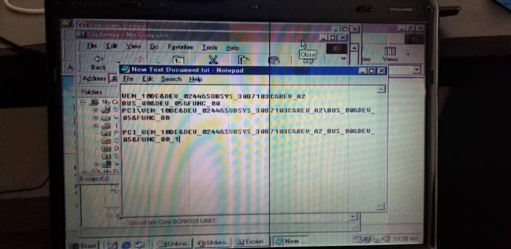

Regarding the ID on the picture, that ID is for the Monitor and the audio I believe. I did find the hardwared ID for the Graphics card and matches the GeforceGo 6150, the same it detects Win98. I will install XP and get a good complete list of the ID so I can still all the drivers and get the drivers working on XP. I did test the Graphics card and works good. I one test and shows some kind of overflow. Will report the complete test after a bit.

Also if this helps, here is the Device ID and Hardware ID:
PCI\VEN_10DE&DEV_0244&SUBSYS_30B7103C&REV_A2\3&13C0B0C5&0&28
PCI\VEN_10DE&DEV_0244&CC_030000
None of the official drivers i have contains DEV_0244. The only driver i found with this ID is the modified one you already have...
