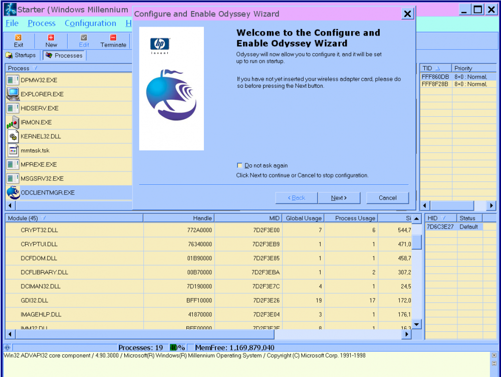

Goodmaneuver Posted July 26, 2020 Posted July 26, 2020 (edited) Yes the MSI file is necessary, it contains the files and execution of the installation. Odyssey has to be installed on 98/ME otherwise the installation will be incompatible because of the missing VXD. Dwmapi was in use in WinMerge in my system and I assume that it was this file that could not be overwritten by the Odyssey installer, it was the only one that made sense to me out of the active modules WinMerge was using. I am using a ReactOS Dwmapi 6.0.6000.16386 and I might be wrong about this particular file it wanted to directly place in the system, it did not say other than it was in use by WinMerge - which I was using at the time. The dcflibrary.dll & odlib_ossl.dll are available from MY-DLL.com and are compatible, there might only be one version of each. If it is just an experiment on your behalf then I think it is best to have chose the USB adapter you had purchased and updated the files I mentioned from 98. I am using a cable connection at the moment and not using my USB adapter, one reason I had not fully installed the client. The picture shows dcflibrary.dll in use. Edited July 27, 2020 by Goodmaneuver proof read correction
