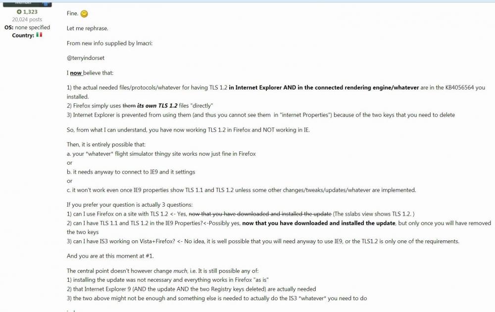

Maybe we need to re-start from the beginning?
Forget for one moment IE9 and TLS 1.2 support in Internet Properties.
Fire up Firefox on that machine.
Open with it this URL:
https://clienttest.ssllabs.com:8443/ssltest/viewMyClient.html
scroll down until you see "Protocol Features/Protocols".
Do you find:
TLS 1.2 Yes
(in green)?
If yes, your current Firefox is using TLS 1.2 allright, then you can try connecting with it to your Flight1 account to validate your purchase.
Post errors (if any) you get when you try to connect to that Flight1 account.

Yep, which means - as expected - that the issue is not TLS 1.2 in itself (as a protocol for browsing) but rather that the *whatever* system IS3 uses makes use of *something* (possibly actually the IE9 "engine" or "subsytem") and that this latter might need to be TLS 1.2 enabled (and possibly something else),
So, back to work.
Did you finally manage to install the KB4056564 successfully?
AFAIK if your system is 64-bit, then you must have the WOW6432Node, unless the OS has been heavily modified, (and even if you hadn't it before, the update should have added it).
Since - reportedly - the update creates the keys in
HKEY_LOCAL_MACHINE\SOFTWARE\Wow6432Node\Microsoft\Internet Explorer\AdvancedOptions\CRYPTO\
that registry path must exist.
On the other hand, if your OS is actuallt 32 bit the 64-bit wouldn't install.
The 32-bit version would create the:
HKEY_LOCAL_MACHINE\SOFTWARE\Microsoft\Internet Explorer\AdvancedOptions\CRYPTO\TLS1.1
HKEY_LOCAL_MACHINE\SOFTWARE\Microsoft\Internet Explorer\AdvancedOptions\CRYPTO\TLS1.2
paths, that you also don't have, so maybe - and for *whatever reasons* the issue is that on your system the KB405654 didn't install properly.
Maybe there is a pre-requisite of some other updates? :unsure:

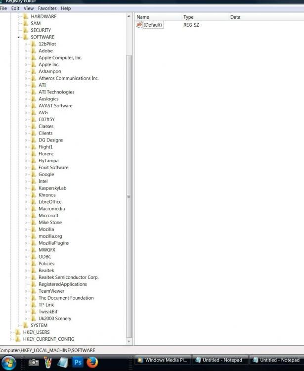

BUT - because you mentioned 32-bit I went on & looked at MS & IE and saw this:     I clicked that John Haller reg file earlier - has that got something to do with this ?

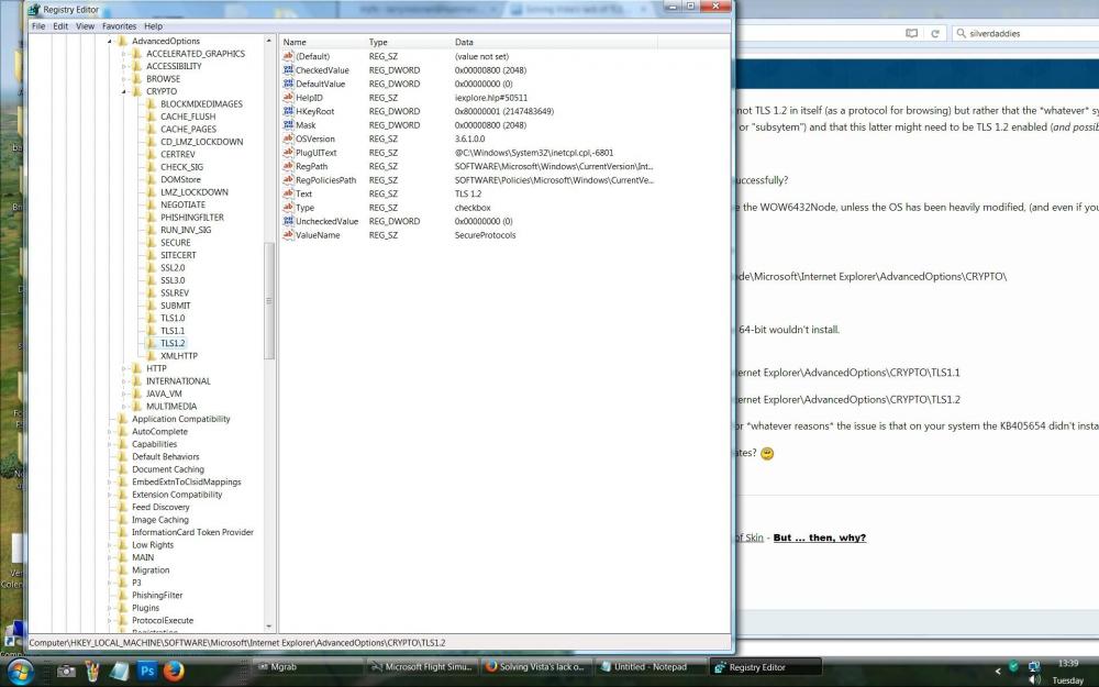

Yes, you see the value:
OSversion REG_SZ 3.6.1.0.0
in HKEY_LOCAL_MACHINE\SOFTWARE\Microsoft\Internet Explorer\AdvancedOptions\CRYPTO\TLS1.2?
Select it (left click), then Right click and choose Delete.
Do the same with the same value in
Then check again Internet Properties.
You can have the same effect if you merge the .reg file on https://johnhaller.com/useful-stuff/enable-tls-1.1-and-1.2-on-windows-vista
or the copy I posted here (again, it is not difficult, select the following:
[HKEY_LOCAL_MACHINE\SOFTWARE\Microsoft\Internet Explorer\AdvancedOptions\CRYPTO\TLS1.1]
"OSVersion"=-
[HKEY_LOCAL_MACHINE\SOFTWARE\Microsoft\Internet Explorer\AdvancedOptions\CRYPTO\TLS1.2]
"OSVersion"=-
open a new Notepad, Paste then save as modtls.reg, then merge into the Registry)
If for whatever reasons the .reg file is not registered on your machine for merging to the Registry, in Regedit File->Import->select the modtls.reg->OK)
Manually or through the .reg file, these two values:
HKEY_LOCAL_MACHINE\SOFTWARE\Microsoft\Internet Explorer\AdvancedOptions\CRYPTO\TLS1.1\OSVersion
HKEY_LOCAL_MACHINE\SOFTWARE\Microsoft\Internet Explorer\AdvancedOptions\CRYPTO\TLS1.2\OSVersion
need to be deleted from your Registry in order to have TLS1.1 and TLS1.2 available in Internet Properties.
