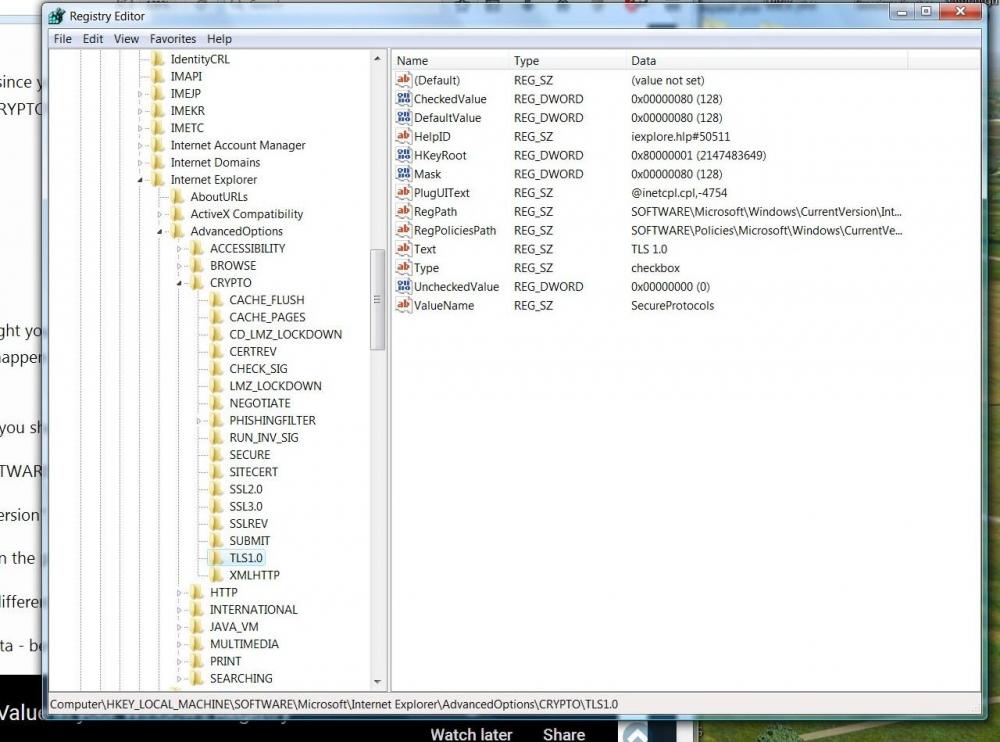

terryindorset Posted July 25, 2020 Author Posted July 25, 2020 (edited) jaclaz - in your helpful regedit tutorial you have: HKEY_LOCAL_MACHINE\SOFTWARE\Microsoft\Internet Explorer\AdvancedOptions\CRYPTO\TLS1.1 a "file" ("value") named "OSVersion". I don't have TLS1.1 just TLS1.0. ALSO, I've read somewhere here that the TLS 1.2 I want to appear in Internet Options to facilitate my validating IS3 is only for Internet Explorer............? I have Firefox 52.9.0. Edited July 25, 2020 by terryindorset

jaclaz Posted July 26, 2020 Posted July 26, 2020 (edited) @terryindorset I believe that: 1) the actual needed files/protocols/whatever are in the KB4056564 you installed. 2) Firefox simply uses them "directly" 3) Internet Explorer is prevented from using them (and thus you cannot see them in "internet Properties") because of the two keys that you need to delete So, from what I can understand, you have now working TLS 1.2 in Firefox and NOT working in IE. The paths are: 32 bit: HKEY_LOCAL_MACHINE\SOFTWARE\Microsoft\Internet Explorer\AdvancedOptions\CRYPTO\ 64 bit: HKEY_LOCAL_MACHINE\SOFTWARE\Wow6432Node\Microsoft\Internet Explorer\AdvancedOptions\CRYPTO\ Check this latter path. Then, it is entirely possible that: a. your *whatever* flight simulator thingy site works now just fine in Firefox or b. it needs anyway to connect to IE9 and it settings or c. it won't work even once IE9 properties show TLS 1.1 and TLS 1.2 unless some other changes/tweaks/updates/whatever are implemented. If you prefer your question is actually 3 questions: 1) can I use Firefox on a site with TLS 1.2 <- Yes, now that you have downloaded and installed the update (The sslabs view shows TLS 1.2. ) 2) can I have TLS 1.1 and TLS 1.2 in the IE9 Properties?<-Possibly yes, but only once you will have removed the two keys 3) can I have IS3 working on Vista+Firefox? <- No idea, it is well possible that you will need anyway to use IE9, or the TLS1.2 is only one of the requirements. And you are at this moment at #1. @Vistapocalypse Allow me to doubt that a restore point exists (or - even if it exist - it can be found): 20 hours ago, terryindorset said: ... the drive died in 2018 & was replaced & everything was reinastalled. jaclaz See edited post below. Edited July 26, 2020 by jaclaz removed assumption, later rephrased

terryindorset Posted July 26, 2020 Author Posted July 26, 2020 (edited) 29 minutes ago, jaclaz said: @terryindorset I believe that: 1) the actual needed files/protocols/whatever are in the KB4056564 you installed. 2) Firefox simply uses them "directly" 3) Internet Explorer is prevented from using them (and thus you cannot see them in "internet Properties") because of the two keys that you need to delete So, from what I can understand, you have now working TLS 1.2 in Firefox and NOT working in IE. The paths are: 32 bit: HKEY_LOCAL_MACHINE\SOFTWARE\Microsoft\Internet Explorer\AdvancedOptions\CRYPTO\ 64 bit: HKEY_LOCAL_MACHINE\SOFTWARE\Wow6432Node\Microsoft\Internet Explorer\AdvancedOptions\CRYPTO\ Check this latter path. Then, it is entirely possible that: a. your *whatever* flight simulator thingy site works now just fine in Firefox or b. it needs anyway to connect to IE9 and it settings or c. it won't work even once IE9 properties show TLS 1.1 and TLS 1.2 unless some other changes/tweaks/updates/whatever are implemented. If you prefer your question is actually 3 questions: 1) can I use Firefox on a site with TLS 1.2 <- Yes, now that you have downloaded and installed the update (The sslabs view shows TLS 1.2. ) 2) can I have TLS 1.1 and TLS 1.2 in the IE9 Properties?<-Possibly yes, but only once you will have removed the two keys 3) can I have IS3 working on Vista+Firefox? <- No idea, it is well possible that you will need anyway to use IE9, or the TLS1.2 is only one of the requirements. And you are at this moment at #1. @Vistapocalypse Allow me to doubt that a restore point exists (or - even if it exist - it can be found): jaclaz jaclaz, THANK YOU. I was getting agitated with that Vistaopocalypse & thinking 'stuff this I'll install W7' & you post your insitghful observations that saves the day. I have to take a neighbour to Bournemouth Hospital & will have a go at your suggestions when I get back this evening.........a long day I think ! Using IE is something I've not done for years ! I've had a quick look & cannot see any Wow6432Node at HKEY_LOCAL_MACHINE\SOFTWARE\Wow6432Node\ Must go I'm late !!! Edited July 26, 2020 by terryindorset
jaclaz Posted July 26, 2020 Posted July 26, 2020 (edited) 2 hours ago, terryindorset said: jaclaz, THANK YOU. I was getting agitated with that Vistaopocalypse & thinking 'stuff this I'll install W7' & you post your insitghful observations that saves the day. I have to take a neighbour to Bournemouth Hospital & will have a go at your suggestions when I get back this evening.........a long day I think ! Using IE is something I've not done for years ! You are welcome, BUT: 2 hours ago, terryindorset said: If you had read my first post you would have seen 'I don't use IE but Firefox but I do want to enable TLS 1.1/1.2 & I will be very grateful if you can tell me how to do it.' Let me repeat I DON'T USE IE BUT FIREFOX'. What do you mean by this 'If you can activate your software by visiting their website using a browser such as Firefox,' ? If you had kept up you will see that I cannot VALIDATE the software becaue my Vista has TLS1.0....see screenshot. Firefox is TLS1.2 enabled but my Vista isn't. What do you mean by activating ? I don't want to activate anything. D'you know, I came here because I was told this site would help me add TLS1.2 to my Vista, but with snide people like you jabbing away I'm beginning to think I shouldn't have bothered. come on, take it easy man , Vistapocalypse is only trying to help you, since the matter is far from being simple/linear it is perfectly normal that willing helping members post doubts, request for confirmations, theories, ideas (crazy or not so crazy), it is the normal process of brainstorming to solve a problem, particularly when the problem is "officially" not resolvable (by MS or by the guys that provide the IS3 of by your local computer support people). jaclaz P.S.: It is rarely the case (but you never know) check that you are using the "right" version of Regedit (i.e. if you are using one, try the other one), among the most confusing explanations on earth (brought to you by the good guys that put in WOW64 32 bit programs and that call "system" the volume that boots and "boot" the volume that contains the operating system): https://support.microsoft.com/en-us/help/305097/how-to-view-the-system-registry-by-using-64-bit-versions-of-windows Edited July 26, 2020 by jaclaz 1
