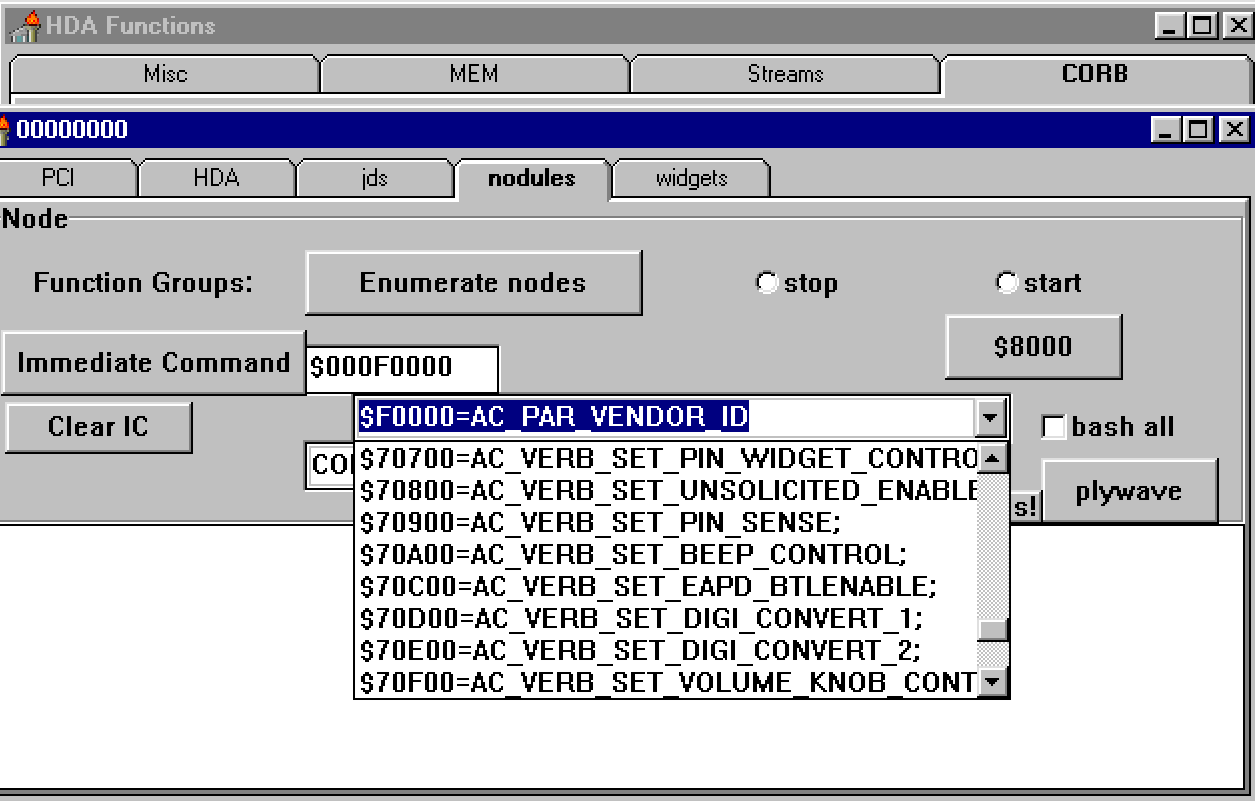

To proceed I suggest to use a HDAICOUT.HDA with SET-verbs between two corresponding GET-verbs, so changes made by SET-verbs can be detected. Further try ONE output-widget at a time. Best start with 'NID: 05'.
Also it is a good habit to end each line with a semicolon and as comment the (more or less) official name of the verb. Most names you can find in my excel notes, or in a box in INTEL.HDA.EXE:
1942972204_INTELHDAnoduleswithopenedverbchoices.thumb.png.371d53240e7da67bf790eac7d4d83aae.png
BTW above all payloads are zero's!
Most of the payloads you can find in my quasi-universal HDAICOUT.HDA, or you can copy/ paste the needed SET-verbs.
For now I would suggest not to play with 'unsollicited response', but always try with and then without 'AC_VERB_SET_EAPD_BTLENABLE (although 'officially' supported on 'NID: 05' only).
The SET-verb of AC_VERB_SET_EAPD_BTLENABLE will be 70C02
