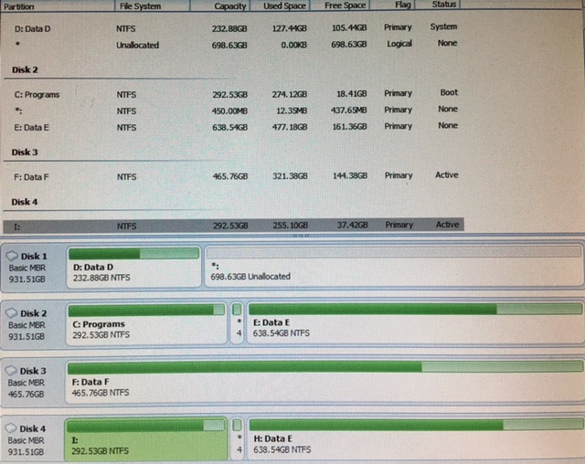

Armando Posted April 8, 2017 Share Posted April 8, 2017 I need some assistance and I hope somebody can assist me. I cloned two hard drives via clonezilla because one of those hard drives has bad sectors. I have Windows 7 64 bit. The original hard drives still work even though one of them has the bad sectors. The cloned hard drives will not boot. I get the message error File: \Boot\BCD Status: 0xc000000f Info: An error occurred while trying to read the boot configuration data. I attempted some solutions that I saw on a few other threads; but, I have had no success. The system recovery options shows. Operating System: Windows7 Partition size: 0 Location: (D:) Local Disk The recovery disc did not resolve the boot error. I have checked the bios for boot start up and it's correct. I followed instructions via another website and noticed a partition is listed a Raw. I tried to convert the Raw partition to NTFS. I followed instructions which were via command prompt - Diskpart that showed D as a raw file. I attempted Chkdsk /r /f d: But I got the message ... the type of file NTFS. Unable to determine volume version and state. Chkdsk aborted. Failed to transfer logged messages to the event log with status 50. Having read many threads it seems that I need to convert the Raw partition to NTFS. The old drives are a WD 1 TB and a 500G Samsung Sata II The two new drives are WD HDD 1 TB WD Black 7200RPM contain the following: A terabyte drive partioned :C drive and :E drive and a 450MB recovery partition The second terabyte drive has the D drive Any assistance would be greatly appreciated. Sorry for post being so long. I was trying to be as detailed as possible. Thanks in advance. Link to comment Share on other sites More sharing options...
Armando Posted April 8, 2017 Author Share Posted April 8, 2017 I was told if I do chkdsk /r /f d: and that it would convert Raw to NTFS. But, it states file system is NTFS even though it is listed as Raw. I think this the reason that I am not able to boot up into the new WD HDD 1TB because it's Raw. Windiws 7 x64 i have two hard drives cloned. One of them has two partitions. On the computer before cloning via clonezilla I had :C and :E on one drive and the second new hard drive I cloned D. Therefore, in the picture Data D actually has data cloned from the D drive ; but is listed under letter C. The data from the C drive was named Program Files and it's not seen under label. I believe it is the Raw file because the size matches. The data from the E drive that was cloned is listed in picture under letter F. Any help would be appreciated. Thanks in advance. How do I fix the Raw issue. I cloned the drives because I believe there were bad sectors. Link to comment Share on other sites More sharing options...
jaclaz Posted April 9, 2017 Share Posted April 9, 2017 Basically (for the one or the other reason) you didn't actually "clone" the disk(s). Contrary of what most people think (and due to the misleading name) Clonezilla very rarely can provide an actual "clone" (as long as we define "clone" an identical copy). The fact that the copies created by Clonezilla (when used properly) are in most cases "good enough" is another thing. Your report is confusing, you talk of the one or the other disk, mixing liberally drive letters (that have no real meaning when talking of disks, since they are - unless some special provisions taken - assigned automatically by the OS depending on an algorithm based on enumeration). What you need to do is to describe (properly) the situation before AND the EXACT way you attempted to clone the original disks. Ideally you should re-connect the original disks as they were and take a snapshot of what you can see in Disk Management (or enumerate disks, partitions and volumes in diskpart). Then do the same with the new sets of disks. Most probably the issue here (since you suspect that there were some bad sectors) is that there are some bad sectors and as such some data in them was not transferred correctly to the "new" disks BUT the difference in drive lettering could mean that )for whatever reasons) you (or Clonezilla or both) missed a partition altogether, as the drive letters are "shifted by one". CHKDISK can often correct minor errors, but it cannot obviously do miracles. Additionally, if you have two hard disks and one of them is developing bad sectors, it doesn't mean that the other will also develop them soon, so there is no real reason to clone the disk that has no bad sectors and what is needed for the one developing bad sectors is not a "clone" (as intended by Clonezilla or similar) but a proper, byte-by-byte, sector-by-sector forensic sound clone, that will most probably anyway need to be analyzed and "fixed" (if possible) and/or data recovered and re-deployed to the new disk (without any actual need for it to be a "clone". You had ORiginally two disks, let us call them OR1 and OR2, which one of them is the WD 1 Tb and which one of the two is the Samsung 500 GB? Which partitions/volumes (drive letters) were on each of them? Which one was the disk where the OS was installed? Was that a "from new" Windows 7 install (thus probably having a 100 or 200 Mb "hidden" partition with the bootfiles) or a more traditional install with the BOTOMGR and \boot\BCD on the C:\ drive (or something else)? jaclaz Link to comment Share on other sites More sharing options...
Armando Posted April 9, 2017 Author Share Posted April 9, 2017 My original drives are Disk 0 and Disk 1. Disk 1 is the original 500G and it cloned with no issues to a 1TB drive. I wanted more storage space. Disk 0 is original drive. This is the drive which I cloned and the cloned drive will not boot up. The diagram shows the cloned drive of Disk 0 which is seen as Disk 3 offline. I plugged it in because otherwise it's not possible to see in disk management because it will not boot up. When I replaced Disk 0 with cloned drive and try to boot up I get error 0xc000000f In the other diagram posted it's seen as a Raw file. I hope this clearer. Link to comment Share on other sites More sharing options...
jaclaz Posted April 10, 2017 Share Posted April 10, 2017 OK. Though something is still not as you described before. DIsk 0 (original) is 1 Tb. Disk 1 (original) is 250 Gb or so (not 500) Disk 2 is the "clone" of disk 1, and it is 500 Gb, not 1 Tb (and the single partition in it has been enlarged from 232,88 to 465.76) Disk 3 is the "clone" of disk 0 (and it is now offline most probably because of a disk signature conflict). The disk 3 can be put "online" by changing (temporarily) the Disk Signature (if it is conflicting and the diks has been put automatically offline), but for the moment it is OK, it seems like the "cloning" at least made the partitions correctly. The 450 Mb (Recovery) and the 638.54 Gb partitions (presumably "Data") should not be involved in the booting at all. In theory the disk 1 and 2 as well should have nothing connected to booting, normally, BUT you seem like having a "mixed approach". The disk 0, partition 1 volume "C:" in the screenshot has the characteristics: Boot, Pagefile, Active Crashdump, Primary partition The disk 1, partition 1 volume "D:" in the screenshot has the characteristics: System, Active, Primary partition Normally (when there is not a reserved small hidden partition for the boot files) a single volume is at the same time Boot and System. The good MS guys have these attributes "reversed" , Boot means that the volume contains the System (in practice C:\Windows\), while System means that it contains the boot files (in practice BOOTMGR and \boot\BCD), see:http://www.multibooters.co.uk/system.html So it seems like your original boot process is: BIOS->Disk1,1(D:)->BOOTMGR->\Boot\BCD->Disk 0,1 (C:)->C:\Windows\System32\WINLOAD.EXE->Windows Normally the 0x000000CF BSOD means that the \boot\BCD cannot be read, so it seems like the issue is actually on disk 2 (the "clone" of disk 1). You can easily verify if this is the case, by removing all disks but disk 0 and attempt booting. (it should NOT boot) and give you a missing BOOTMGR error Then try adding disk 1. (it should boot as before). Then try removing disks 0 and 1 and add only disk 3 (it should NOT boot) as with just disk 0 connected. Then try adding only disk 1 (yes disk 1). What happens? As a side note (not necessarily connected to the issue) since right now you have both Disk 1 and disk 2 "online" it should mean that in the process -somehow- the disk signatures of them were made different. jaclaz Link to comment Share on other sites More sharing options...

Armando Posted April 11, 2017 Author Share Posted April 11, 2017 I was never able to boot up with the cloned disk 3 drive. The :c partition was seen as raw. Once again I was not able to recover it wit AOMEI recovery partition. Disk 0 (original drive) is the drive which I have an issue with when I cloned it with clonezilla. The cloned drive in diagram was Disk 3 (cloned drive). I believe it's due to bad sectors in the :c partition. I will attempt another clone with AOMEI backupper. I stand corrected on Disk 1 being 250G. The cloned Disk 1 drive works perfectly. Disk 2 is the 500G drive and I have done nothing with that one. We can ignore that drive. Sorry for the confusion. Thanks for your patience. Link to comment Share on other sites More sharing options...

Armando Posted April 12, 2017 Author Share Posted April 12, 2017 Disk 2 is (original drive) this HDD is going bad. Disk 4 is (clone of Disk 2) When I remove Disk 2 (original) and try too boot up using Disk 4 (clone) I get error 0xc000000e Does anybody have a solution? Thanks in advance. I did double check the bios. Link to comment Share on other sites More sharing options...
Armando Posted April 12, 2017 Author Share Posted April 12, 2017 (edited) Two hard drives are the same and the third is different. I resolved the RAW issue. But, I now encounter a 0xc000000e error when I attempt to boot up with with Disk 3 (clone hard drive) of Disk 0 (original hard drive). Edited April 12, 2017 by Armando Link to comment Share on other sites More sharing options...
jaclaz Posted April 12, 2017 Share Posted April 12, 2017 To understand what is happening, I need to know what happens if you do the experiment with just the Disk 0 attached (the original "first" disk, the one that has volumes C: and E: in your screenshot). jaclaz Link to comment Share on other sites More sharing options...
