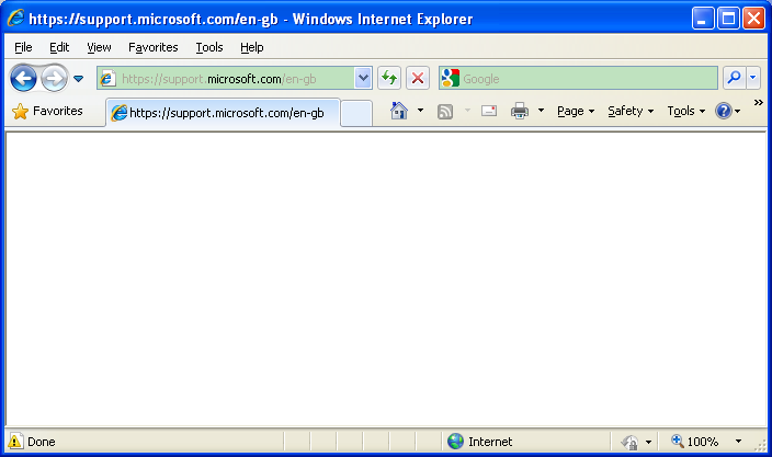

Dave-H Posted October 15, 2016 Author Posted October 15, 2016 Thanks Den, now I remember going through exactly this when I was having the same problem with IE6 on Windows 98 earlier in the year! The reg update has got rid of the update nag as you say, but all the Microsoft Support pages are now just being displayed as plain white blank pages with no content. Is that what you would expect? The Windows Help and Support Center is still saying it can't dispaly a lot of pages too. I don't think IE9 is still supported either, so can IE8 be made to look like the current version, IE11, or is that not possible?

Dave-H Posted October 16, 2016 Author Posted October 16, 2016 18 hours ago, dencorso said: You can try. Look, with a text editor (notepad will do) for the line that says "Version"="MSIE 9.0" and change the 9 by 10 or 11. Save and merge. Reboot or, at least log out then log in the profile. It should work as far as spoofing goes, but IIRR, pretending to be more than 9 results in garbled displays on IE8. YMMV, however. If you decide to try it, let me know how it went. I do spoof IE10 as IE11 on 7 ultimate sp1 x64 successfully, too. But that requires a longer reg file. Well I tried spoofing as IE10 and IE11, and it made no difference at all, things were exactly the same as when it's spoofed as IE9. All the Microsoft support pages are still just plain white pages with apparently no content, although if you look at their source, everything appears to be there, it's just not being displayed! I compared the registry entries on Windows 8.1/IE11, and most of the ones that are on XP, although they are all present, seem to be blank on 8.1. I guess that's all that can be done.
dencorso Posted October 16, 2016 Posted October 16, 2016 One can spoof IE version for everybody but it cannot fool MS... and it's adamant on refusing to talk to IE8... Then again one can visit those pages with FF/Opera/Chrome/etc. (well, mostly...)!
jumper Posted October 16, 2016 Posted October 16, 2016 > All the Microsoft support pages are still just plain white pages with apparently no content, although if you look at their source, everything appears to be there, it's just not being displayed! The content is likely styled as hidden by default and needs an external stylesheet or scripting to make it visible. Try menu option View->Style->No Style. (It often works for non-IE browsers.) Enable scripting and check the error log (F12 ?). Check the Hosts file for blocked servers. HTTPS is obviously a problem. The CSS file might be linked via https on a secure server using encryption not supported on your system. If we can upgrade your security support so that pages like WMP load via https, then CSS support files might also load properly. If a scripting update is needed, we might be able to use xompie to get the IE9 or 10 Jscript.dll file to work in XP. My only XP/IE8 system is not Internet connected, so I can't test any of this myself. :-(
Dave-H Posted October 16, 2016 Author Posted October 16, 2016 (edited) Switching off styling brings back a garbled display, so I'm sure you're right, the CSS isn't working. Well this doesn't look too promising! Edited October 16, 2016 by Dave-H Typo

dencorso Posted October 18, 2016 Posted October 18, 2016 3 hours ago, sdfox7 said: Dave Have you tried restoring IE to its default settings? I do know for a fact that Frame worked well with IE 6 on many websites just a couple of years ago. I find it hard to believe that web developers would have removed the code this quickly. Hard to belive? Never underestimate the MS geniuses! @Dave-H: Never mind. It'll be useless. I get the same result here, look:
